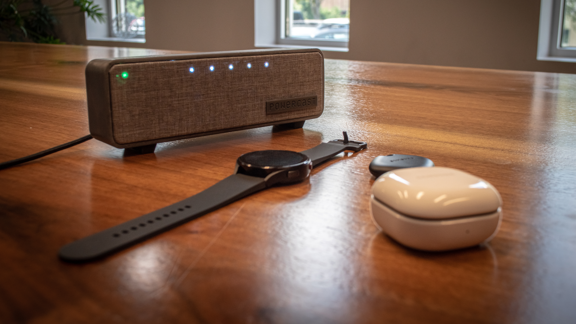

Courtesy Powercast
Powercast's Ubiquity RF power transmitter

Powercast will be at CES 2023 with its Ubiquity RF power transmitter, a device it hopes can make a pervasive presence of RF wireless power in smart homes. With this transmitter, Powercast claims to have lowered the barrier to entry into having multiple RF wireless power transmitters covering every home.
The idea of the Ubiquity transmitter is to make wireless charging a “set-and-forget” proposition, much like Wi-Fi. Powercast’s over-the-air wireless power architecture has two sides:
  • A transmitter sends RF over the air
  • A receiver embedded in end devices harvests that RF from the air and converts it into dc (direct current) to both communicate data and power devices.
On the transmitter side, Powercast’s Ubiquity will come in several forms, all able to both charge RF-enabled devices and communicate data back and forth with them throughout a home. Manufacturers have two options to turn their own products—such as home appliances, TVs, game systems, computer monitors or AI-enabled home assistants—into Ubiquity RF transmitters:
  • A licensable reference design provides flexibility and ultimate cost savings for manufacturers to integrate just the electronics needed onto their own circuit boards for $5 or less bill-of-materials (BOM) cost.
  • An easy-to-integrate, drop-in embeddable module contains all of the electronics and hardware needed. Manufacturers will add a power supply and antenna. Powercast will work with manufacturers on an antenna design that best fits their specific product size.
On the receiving side, manufacturers can embed Powercast’s tiny Powerharvester PCC110 receiver chip and a small antenna into their end devices for around $1 to enable them to work with an RF transmitter—either Powercast’s standalone Ubiquity, or RF-transmitting products created using the Ubiquity embeddable module or reference design.
This wireless power-over-distance architecture is perfect for charging low-power devices with continuous, reliable, background trickle charging. End-device examples include TV remotes, electric toothbrushes, keyboards and mice, game controllers, earbuds, headphones, smart watches, fitness bands, hearing aids, clocks, electric shavers, home automation devices and many more devices.
The Ubiquity transmitter can output up to 1 W (3 W EIRP) and automatically charges multiple RF-enabled devices that come into its charging zone, with no charging mats needed. Power-hungry devices charge faster within several feet of the transmitter, while ultra-low-power devices like IoT sensors can charge up to 120 feet.
