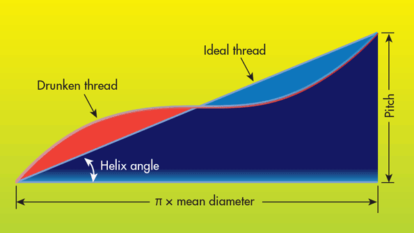

This visual interpretation of thread drunkenness represents the unwinding of the thread from the screw cylinder.
Thread drunkenness is defined as the erratic pitch error occurring within intervals of one pitch. This concept is hard to visualize unless it is represented by unwinding the thread from the screw cylinder, as shown above.
Guided by ISO, DIN, and JIS industrial standards, many design engineers broadly define lead accuracy of ball screws only in terms of error accumulated over 300 mm (V300). However, they regularly overlook the value of measuring or controlling lead accuracy per revolution (V). Often referred to as ball-screw drunkenness because of the hard-to-predict wobble it introduces into ball-screw operation, lead accuracy per revolution is emerging as a critical parameter in miniature screw applications where overall travel length is less than 300 mm.
