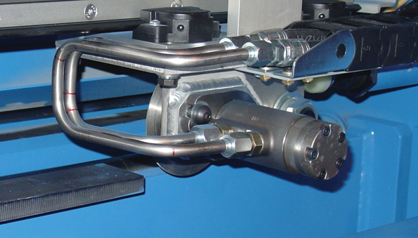

This small hydraulic motor has a body diameter of only 1.75 in., but it’s rated to generate about 150 lb-in. of torque at 1,500 psi.

Most gerotor motors have a number of options for mounting flanges, shafts, and seals. In applications where space is tight, some motors can even mount just using the ports. Motor manufacturers offer many common shaft options as well. Usually, a short or long keyway works for most tasks. Other times, flats are machined on the shaft and setscrews lock a device to the motor. When transmitting sizable torques, shafts with splines on the ends are often recommended.
