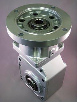

Though sound and noise analysis cannot diagnose all potential gearbox or gearmotor problems, sound measurement can provide valuable clues about a gearbox's condition. Here we review one approach.
Sometimes a gearbox problem can be easily identified by the sound it makes during operation. Conversely, other situations exist for which “normal sounding” and “abnormal sounding” are simply too ambiguous to be of any diagnostic value.
By understanding what sound is and applying some fundamental techniques, it's possible to clearly quantify the sound that a gearbox or gearmotor generates. The measured value, by itself, may not be used as a diagnostic tool, but may provide significant clues to the OEM, gearbox manufacturer, or even the operator regarding a unit's condition. This may provide a starting point for root cause analysis and, ultimately, corrective action.

Gearboxes and gearmotors generate operational sounds in a variety of ways: Gear mesh, bearing rotation, lubricant splash, oil pump operation, and the interaction of the gearbox within the machine structure all contribute to the overall sound generated by a gearbox during operation.
