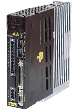

The P-series drives and motors are designed for flexibility to accommodate several motors and prevents the constant switching out of drives.
While the K-Series provides customization for specific designs, Parker Hannifin’s P-Series of motors and drives provide flexibility. For Gantry and Cartesian robots, motors and drives need to have general-purpose utility and be flexible so that one prevents the constant switching out of drives. The P-Series drives and motors operate in a variety of machine-controlled architectures. The drives have EtherCAT connectivity for high-speed motion bus, USB communications for convenient setup, and 8 inputs/4 outputs with EtherCAT models. The Safe Torque Off feature for the EtherCAT models immediately cuts power to the motor, then dynamic braking quickly brings the motor to a stop.  The line of drives from Parker Hannifin also has auto-tuning features. In real time, the drives can apply tuning via adaptive resonant filters and detecting vibration peaks to dial in inertia and tuning gains. The P-Series motors need to be flexible, which is why they follow the BiSS-C standard for open-source absolute-encoder design. Absolute encoders are becoming the norm for drives due to their cost-saving benefits.

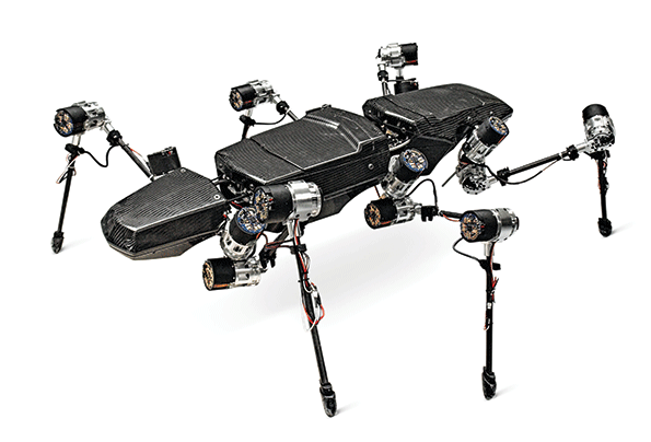

Hector can walk independently and respond to obstacles via the complex sensors collecting data of the surrounding environment. (Image courtesy of Bielefeld University)
As mentioned earlier, robots are leaning away from assembly and automation, and shifting focus toward entertainment and personal assistance. The robot in the image is called “Hector” and was developed by the Biomechatronics Research Group at Bielefeld University. The robot is about 3 feet tall and weighs 26.5 lb. The exoskeleton consists of carbon fiber-reinforced plastic, which makes it extremely lightweight. The purpose of the project is to achieve better control of underlying coordination principles as well as to investigate the fundamental concepts of how to elastically control actuated driven robotic systems.
Hector has three EC 45 flat motors on each of its legs, delivering 50 watts of power per motor to the robotic movements. (Image courtesy of Maxon Precision Motors)
Each individual leg of the robot contains an EC 45 flat Maxon motor, with a total of 18 motors. The EC 45 flat is a brushless motor delivering 50 watts of power at a diameter of 45 mm. The motors for this particularly design are custom built by Maxon, as the elastomer couplings were integrated directly into the drives.

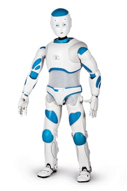

Romeo comes from a family of robots designed by Aldebaran. The other two are Pepper, which uses wheels to roll around, and Nao, the smallest. (Image courtesy of Aldebaran Robotics)
The next phase of robotics will introduce personal assistants. “Romeo,” designed by French robotics company Aldebaran, aims to be the perfect assistant for the elderly. Romeo is almost 5 feet tall and weighs 81.6 lb. The researchers at Aldebaran are currently testing to see how far they can push Romeo’s limits. The goal is to maximize its walking ability, navigation, and human-robot interaction. Eventually Romeo will be able to respond to human body and facial expressions.
The RE 40 motors used in Romeo have iron-less Maxon winding, which ensures precise control and current that is proportional to torque. This allows the controller to use current measurements to determine when Romeo has encountered an obstacle or has collided. (Image courtesy of Maxon Precision Motors)
Romeo uses 37 Maxon RE 40 motors. The RE 40 motor uses graphite brushes at 150 watts of power. The RE 40 has a 40 mm diameter and has nominal torque ranges of 94.9 mNm to 190 mNm. The motors come with iron-less Maxon winding, ensuring excellent control behavior.

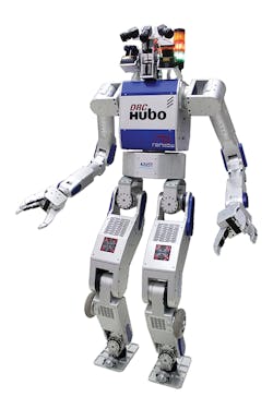

DRC-Hubo won the 2015 DARPA Robotics Challenge and the KAIST (Korea Advanced Institute of Science and Technology) and the Rainbow Co. were awarded $2 million in prize money. (Image courtesy of KAIST and Rainbow Co.)
The DRC-Hubo robot was one of the first-place finalists of the DARPA Robotics Challenge in 2015. The DARPA Robotics challenge consists of realistic scenarios such as driving a car, cutting holes into walls, opening doors, and negotiating difficult and uneven terrain. The Korea Advanced Institute of Science and the Rainbow Company built the robot in conjunction using 33 Maxon motors, mainly the EC-4pole 30 brushless motor. The robot operates on two legs, but benefits from being able to utilize rollers built into the knees. This helped Hubo complete the required competition tasks in the shortest time. The robot has an aluminum casing instead of plastic, stands 6 feet tall and weighs 176.4 lb.
The EC-4pole 30 brushless motor from Maxon achieves maximum power in Hubo by being operated in overload conditions in conjunction with cooling fans. (Image courtesy of Maxon Precision Motors)
The EC-4pole 30 brushless motors deliver significant power at 200 watts per motor. The Hubo uses 25 of these motors, which operate at overload conditions. The robot was equipped with cooling fans so that the motors could operate safely even in overload conditions. Hubo demonstrates the closest example of how technology of today can be used to advanced and push the capabilities of modern robotics.
