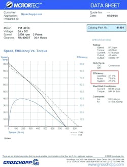

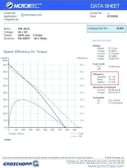

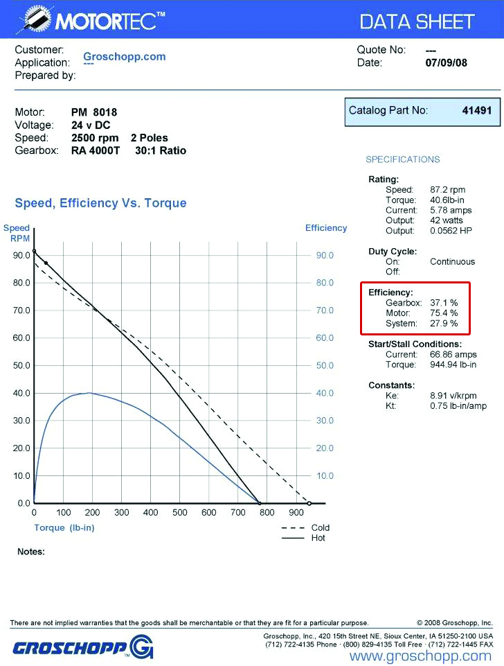

  • Understand what gearmotor system power really means.
    When specifying and selecting a gearmotor, it's critical to know and understand gearmotor system power, and not just motor power. Typically, gearmotor manufacturers publish specified motor output power, which often does not accurately convey actual gearmotor output power; when specifying or selecting a gearmotor for an OEM application, relying on this published motor power specification (hp) alone can be deceiving. To fully optimize a gearmotor solution, calculate or obtain system output power, which represents the resulting gearmotor power after calculating the efficiency of both the motor and the gearbox.
  • Understanding system power and knowing separate motor and gearbox efficiency ratings also gives an engineer important data with which to make comparisons. For example, comparing efficiencies of a planetary gearmotor to a parallel shaft gearmotor allows product choices to be made based on overall efficiency, performance, and cost.
    So, when selecting a gearmotor, determine if published power or output power specification is for the motor only, or if this specification also includes the gearbox/speed reducer efficiency. Any gearmotor vendor should be able to provide both motor and gearbox efficiency ratings; if it is not calculated as system power, calculate gearmotor system power by multiplying motor output power by the appropriate gearbox efficiency.
