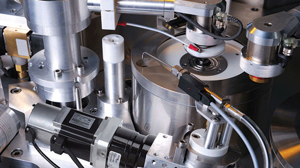

This servomotor and precision planetary gearbox control a rotary arm in a dispensing machine, to give highly accurate positioning as required by this demanding application.
