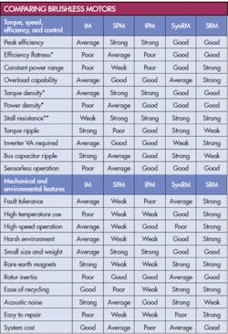

This table of comparisons is just a starting point for engineers looking for the right brushless DC motor. The actual choice should always be application-dependent, and engineers should know that manufacturer’s ratings can vary from one vendor to another. Surface rotor magnets (SPMs) and interior magnet motors (IPMs) are both varieties of permanent magnet motors (PMMs). *AC, SPM, and IPM motors perform poorly in the high-speed (field-weakening) range **Stall capability of IM is poor unless motor is fed by an inverter
