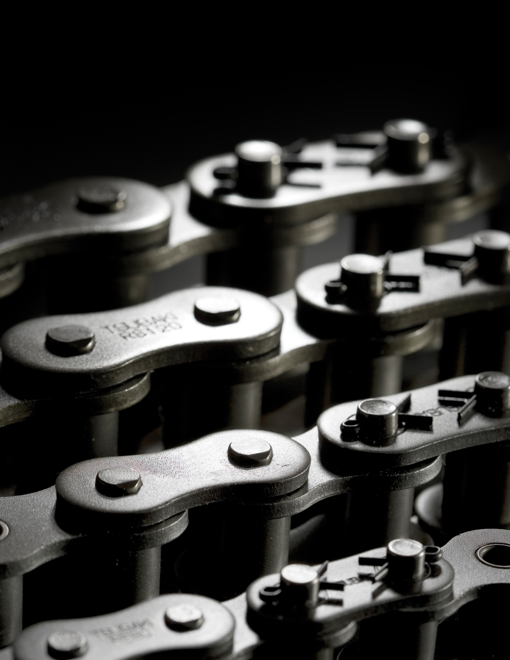

Explanation of wear and elongation
Wear occurs on chain in three primary ways:
• Articulation of the pin against the bushing when the chain enters and exits a sprocket
• Rotation of the rollers against the bushing when engaging a sprocket
• On the side plates if there is rubbing or sliding on a guide.
The area between the pin and bushing is both the most critical and the most difficult area to lubricate because it is internal to the chain; this is the area responsible for wear elongation.
Through normal operation, chain eventually elongates due to wear between the pin and bushing. Some refer to the increase in length as stretch. However, when properly loaded, it is due to wear, not actual deformation of components.
For drive applications with fewer than 60 teeth on the sprocket, replacement of the chain is suggested when it reaches 1.5% elongation, measured over at least six pitches; however, a longer length of chain allows an even better assessment. (For conveyor applications, chains can be used up to 2% elongation.)
Chains can operate with up to 3% elongation, but this may result in sprocket damage, chain-jumping sprocket teeth, unexpected loading, or increased vibration and noise.
Chains used beyond the suggested amount of wear lose fatigue strength due to material being worn from the pin.
Note: Regardless of average chain elongation, if any single pin-bushing joint experiences excessive wear, it may be necessary to replace the chain.

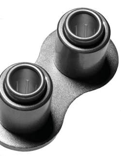

Sealed roller chains
Sealed chains are useful in applications with especially high levels of abrasives or particulates that could otherwise accumulate inside the chain. Dimensionally, this class of chains is wider than standard to accommodate the seal between the plates.
Traditional O-ring chain is designed with a rubber seal compressed between the pin link and roller link plates to hold lubrication between the pin and bushing and keep contaminants out; however, it is not considered a lube-free chain. Lubrication is still required for the roller and to keep the O ring from drying out.
With bearing bush chain, needle bearings are installed between the pins and bushings. These add rolling elements between these components and eliminate sliding friction. After a minimal break-in period, these chains do not stretch.
One bushing incorporates lube grooves on the inner surface to keep chain running longer without additional lubrication. The feature is found on Tsubaki’s PerforMax chain in sizes 80 to 140.
Once the lubrication within the pin-bushing joint is consumed, additional lubrication is prevented from entering because of the O ring. Because the O rings are under compression between the plates, the resultant friction leads to a greater force requirement to articulate the chain, decreasing the transmitted power. At places where chain tension is low (such as the return side), the strand may not fully straighten without an added tensioner.
Some chain varieties offer the benefits of lube-free operation plus a felt seal between the pin link and roller link plates. The bushing is extended to help keep the felt from compressing. The self-lubricating bushing is in contact with the roller and bushing to control wear, plus the felt helps to keep contaminants from entering the roller-bushing area. Unlike regular O-ring chain, this kind of chain is both sealed and lube free, and allows free flexing.
