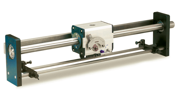

Rolling-ring friction drives generate linear motion without ball screws, clutches, or gears.
Rolling-ring drives come in both fixed-pitch and variable-pitch models. Fixed-pitch versions operate more or less as threadless screws. These drives handle incremental positioning and PLC-controlled operations such as in metrology machines. The required controls are similar to those in conventional screw-based drive systems.
For many applications, however, variable-pitch rolling-ring linear drives eliminate the need for electronic controls, as pitch can be precisely adjusted and even set to zero. Travel direction and linear speed are mechanically controlled independently of the motor. This simplifies both design and operation of the linear-motion system. Variable-pitch rolling-ring drives are used in reciprocating linear-motion applications such as ejecting, cutting, spraying, and winding.
