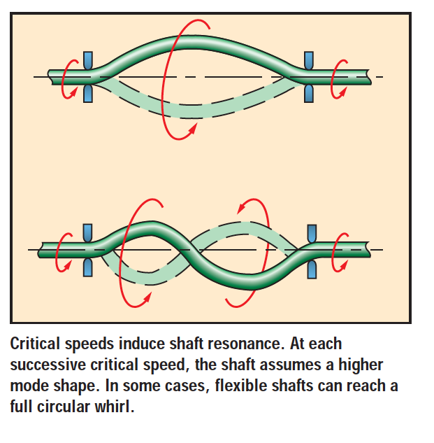

Speed adds further complications. A rotating part must be built so it doesn't operate near its critical speed. Due to imperfect fabrication, the center of mass of any axle or shaft is offset (if only slightly) from the axis of rotation. As speed increases, centrifugal force exaggerates the eccentricity, pulling outward on the shaft. At critical speed, the shaft resonates, vibrating over or even whirling around the rotation axis, and the displacement amplitude can rapidly become destructive. The critical speed is very close to the lateral natural frequency, although dynamic factors can set them apart a bit.

A. Bearing end conditions are a complex and crucial factor in shaft behavior. Bearings that allow the shaft to pivot under a transverse load make for easier shaft bending and a lower lateral natural frequency. From another standpoint, soft or loose end supports allow radial movement of the shaft centerline, so the shaft can resonate yet remain straight. Prohibiting this radial end movement forces the shaft to flex under resonance, and raises the critical speed.
Q. Can a shaft be pushed safely beyond the first critical speed?
A. Yes. In some machinery, shafts are designed to accelerate quickly past one or more resonance frequencies to reach operating speed. Significant bearing damping is helpful when moving through these critical speeds. Above the first critical speed, rigid shafts sometimes become flexible.
