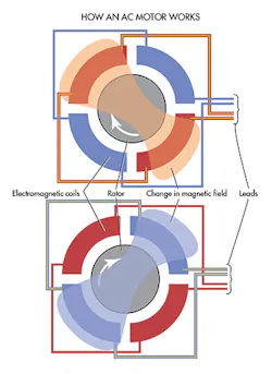

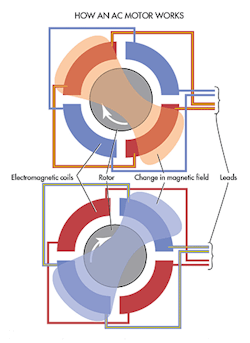

AC motors use a ring of laminated metals to generate a magnetic field when AC current is applied. The electromagnets encircle a rotor. The AC causes the strength the electromagnets’ magnetic field to rise and fall, creating a shifting magnetic field that generates torque.
There are two pairs of electromagnetic coils that are energized in turn by an ac current. The pairs are set out of phase with each other so that the rise and fall of the ac current will alter the magnetic field between them. This change induces an electric current in the rotor that produces its own magnetic field. The rotor will try to oppose the magnetic field from the coils, but since the field is changing with the ac current, the rotor will turn.
AC motors offer higher torque and speeds, compared to DC. They also are more adaptable to variable speed and loads, so it works better for hills. It also accepts energy from regenerative braking easier than a DC motor. But the coil winding can be heavy, and an inverter is necessary when using batteries. In general, an AC motor’s overall cost is higher than that of a comparable DC motor.
