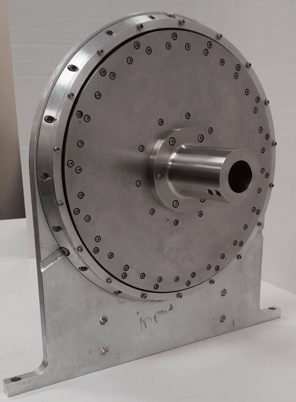

Toliyat’s group has worked on three basic configurations of magnetic-gear designs: an axial gear, a radial gear, and a trans-rotary gear. Axial designs have a configuration resembling that of a clutch pack or pancake motor. They consist of two disks each containing alternating positive and negative magnets with a modulator disk in between. The low-speed disk, or low-speed rotor, contains a magnetic pattern geometry that alternates more quickly than that of the high-speed rotor. Thus there are more pole pairs on the low-speed rotor than on the high-speed rotor. The gear ratio is a function of the number of pairs on the two rotors and the air-gap fluxes they produce. The amount of torque transmitted is a function of the flux linkages between the two disks and is affected by the size of their magnets. So as the size of the magnetic areas grows smaller — as when cramming in more pole pairs or reducing the diameter of the rotors — there is a point of diminishing returns as radial-flux leakage becomes more of a problem.
Radial magnetic gears have a configuration that resembles that of a synchronous motor. A typical topology uses a high-speed inner rotor concentric with a low-speed outer rotor. The two rotors are separated by a stator typically composed of electrical steel bars. As with axial magnetic gears, the stator bars modulate the flux between the permanent magnets on the input and output rotors.
Axial magnetic gears are probably the most challenging basic topology, say researchers in Toliyat’s group. “There can be huge axial forces on the bearings so there are a lot of issues,” explain Texas A&M Ph.D. students Matt Johnson and Siavash Pakdelian. They also say axial designs are tougher to analyze than those of other configurations because an accurate analysis requires a full 3D model whereas other topologies can be simplified for analysis using symmetry. And as currently constructed, axial designs would be more difficult to manufacture than magnetic gears using radial or trans-rotary configurations.
Manufacturing considerations are among the reasons why industry seems to have more initial interest in building radial magnetic gear designs than axial designs. Radial magnetic gears have a configuration that resembles that of a synchronous motor. A typical topology uses a high-speed inner rotor concentric with a low-speed outer rotor. The two rotors are separated by a stator typically composed of electrical steel bars. As with axial magnetic gears, the stator bars modulate the flux between the permanent magnets on the input and output rotors.
Radial and axial magnetic gearbox prototypes from the Texas A
