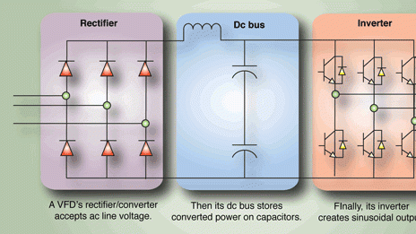

Variable frequency drives (or VFDs) are widely used throughout industry to provide adjustable speed control of ac motors. Although modern versions are relatively simple to install and operate, VFDs are quite complex, containing a myriad of advanced hardware and software. VFD implementation and operation can often be improved by understanding internal VFD processes. To that end, we present the terminology used to describe VFD internal operations and external interfaces. This lesson contains 40 of the most important VFD terms for today's design engineers.
1. Rectifier/converter: One of the three primary sections of a VFD's main power circuit, and first in terms of power flow. Incoming ac line voltage is rectified to dc voltage in the converter section, which consists of diodes, silicon-controlled rectifiers (SCRs), or insulated gate bipolar transistors (IGBTs) connected in a full-wave bridge configuration.
2. Dc bus: The second primary section of a VFD's main power circuit, chiefly comprised of capacitors that store power rectified by the converter.
3. Inverter: The third and final primary section of a VFD's main power circuit.
The inverter section is comprised of IGBTs that create sinusoidal output current using pulsed dc bus voltage, or pulse width modulation (PWM). VFDs themselves are sometimes called inverters, as the presence of an inverter section is the primary difference between VFDs and dc drives.
