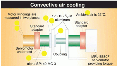

Refer to the image on convective cooling: Mounting plate dimensions are taken from Rockwell Automation's MP-Series low-inertia servomotor with 100 to 1650mm frame size. To obtain the specified motor thermal rating, the motor is mounted (as instructed in literature) on a surface with heat dissipation equivalent to a 12 x 12 x 0.05-in. aluminum heat sink.
The MPL-B540K servomotor coupled to an alpha SP140-MC1-3 gearhead combination on the left is the unit under test. The servomotor-gearhead combination on the right supplies torque to the unit under test.
Eight thermocouples monitor temperatures; limiting temperature is at the gearhead output bearing, so the termocouple here is monitored to determine when steady state is achieved - defined here as no more than 1° C rise over a 15-minute period.
