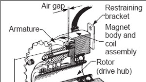

Most electric brakes and clutches are installed in a direct-drive configuration, and alignment is just as important as it is with a motor. If bearings and shafts are not aligned, extra stresses and vibrations that develop can turn into major problems. Most industrial clutches and brakes are similar in design and have a small air gap between armature and magnet body. The effect of any misalignment is magnified, particularly on clutches, and can cause vibration and torque loss.
When you install or replace clutches or brakes, be aware that there are NEMA specifications on how they fit to motors or gearboxes, governing tolerance ranges for things such as register and bolt circles. Brake and clutch manufacturers set their design criteria to be compatible with this “window,” and proper alignment is normally the equipment manufacturer’s responsibility. You can incurtrouble when mounting a new brake or clutch on used equipment if you don’t assure that motors or drives remain within NEMA tolerances. If the motor end bearings are worn, any shaft wobble will be exaggerated farther from the motor where the clutch or brake may be mounted — and what is really a motor problem may first show up as clutch or brake failure.
To avoid trouble, measure shaft runout both axially and radially, and check it against NEMA tolerances. These are usually around 0.004 in. radially and 0.002 in. axially, but they vary some by motor size. Also, check motor-shaft end float. Most equipment can tolerate float up to about 0.020 in. Most manufacturers’ instruction sheets include allowable indicator runouts for mating equipment.
Overhung loads can cause trouble. Particularly on clutch applications with a sprocket or sheave, there is a limit to the side force or tension you can apply without overloading the bearing and deflecting the output shaft.
If a unit has a retaining bracket, don’t bolt it down tightly or weld it in place unless you want premature failure. The retaining tab is mainly to prevent rotation when the clutch is applied, and it is necessary only to pin it in place so it is somewhat free-floating. Bolting it tightly can create hub-and-shaft misalignment and bearing prestress. This can lead to quick clutch failure and even drive damage.
