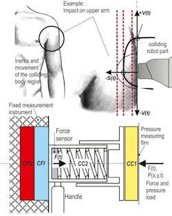

Schematic diagram of the KDMG-KOLROBOT instrument. (Source: IFA - Technical information COBOTS: Collaborative robots - Test apparatus)

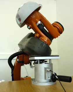

Prototype of the force/pressure instrument in the application. (Source: IFA - Technical information COBOTS: Collaborative robots - Test apparatus)

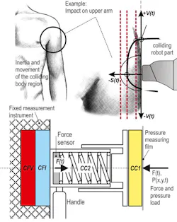

Once each potential contact situation has been classified and the limits established, each must be tested or evaluated. The method used depends on the specific type of impact.
For quasi-static contact situations, a proper test device which mimics key characteristics of each part of the human body must be used. This includes having a proper spring rate and damping material which simulates the shore hardness of that particular area. This also includes a pressure mapping component such as film. Some of these devices are currently available in the market today. The test device is properly anchored, and each potential collision is carried out. The data from each collision is recorded and compared to the limit values published in ISO/TS 15066 & (RIA TR 15.606)
Transient contact situations can be evaluated in two separate ways. In the first method, both the robot system mass and the body region mass must be accounted for. This means that the test device must be attached to an apparatus that allows it to move freely and must also be the same mass as the effective mass (MH) of the body part being tested. The effective mass is defined in table A.3 of ISO/TS 15066 (RIA TR 15.606). The same test procedure as the quasi-static procedure is then followed.
The second method of evaluation utilizes mathematics as opposed to physical testing. For each body region the maximum permissible energy transfer can be calculated as a function of the maximum force or maximum pressure values given in table A.2 of ISO/TS 15066 (RIA TR 15.606). The calculation will show the maximum speed at which the robot can travel for each given situation.
Force-time signal of a human-robot collision (Source: IFA - Technical information COBOTS: Collaborative robots - Test apparatus)
