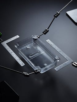

The company was able to easily integrate the Multiplier into the existing prototyping workflow, preserving key aspects that were already efficient and optimizing those that caused issues, Heuer said. “I still use Solidworks to design the packaging prototype; however, instead of 3D printing a visual prototype to present to the product management team and then outsourcing to the packaging supplier, I 3D print a thermoforming template of the design,” he said. “I then use the Multiplier to create high-fidelity prototypes that I present to the team and testers. All of this can be done within a day.”

Because of the nature of pressure forming, there are some important design considerations to ensure the best results are achieved, Smilansky says. “To get a successful part, users need to design for pressure forming, which means creating parts with no undercuts, that use air vents to ensure air flow around the template, have draft angles on straight walls, and are not taller than they are wide,” he said.
Heuer explains that Oertli experienced some challenges in thinning of the foil in areas with too high ratios (width-to-depth) and bridging in areas of thin gaps.
“We switched from negative to positive molds to move the functional areas to regions of low stretch,” he explained, “and found the minimal gap size to reduce bridging by manipulating the printed model and then reforming.” He says that the best results are achieved with high-temperature resin printing or filaments such as nylon or Nylon CF. “At this point, we are using standard PLA and discarding the template after a certain number of molds,” he said.
