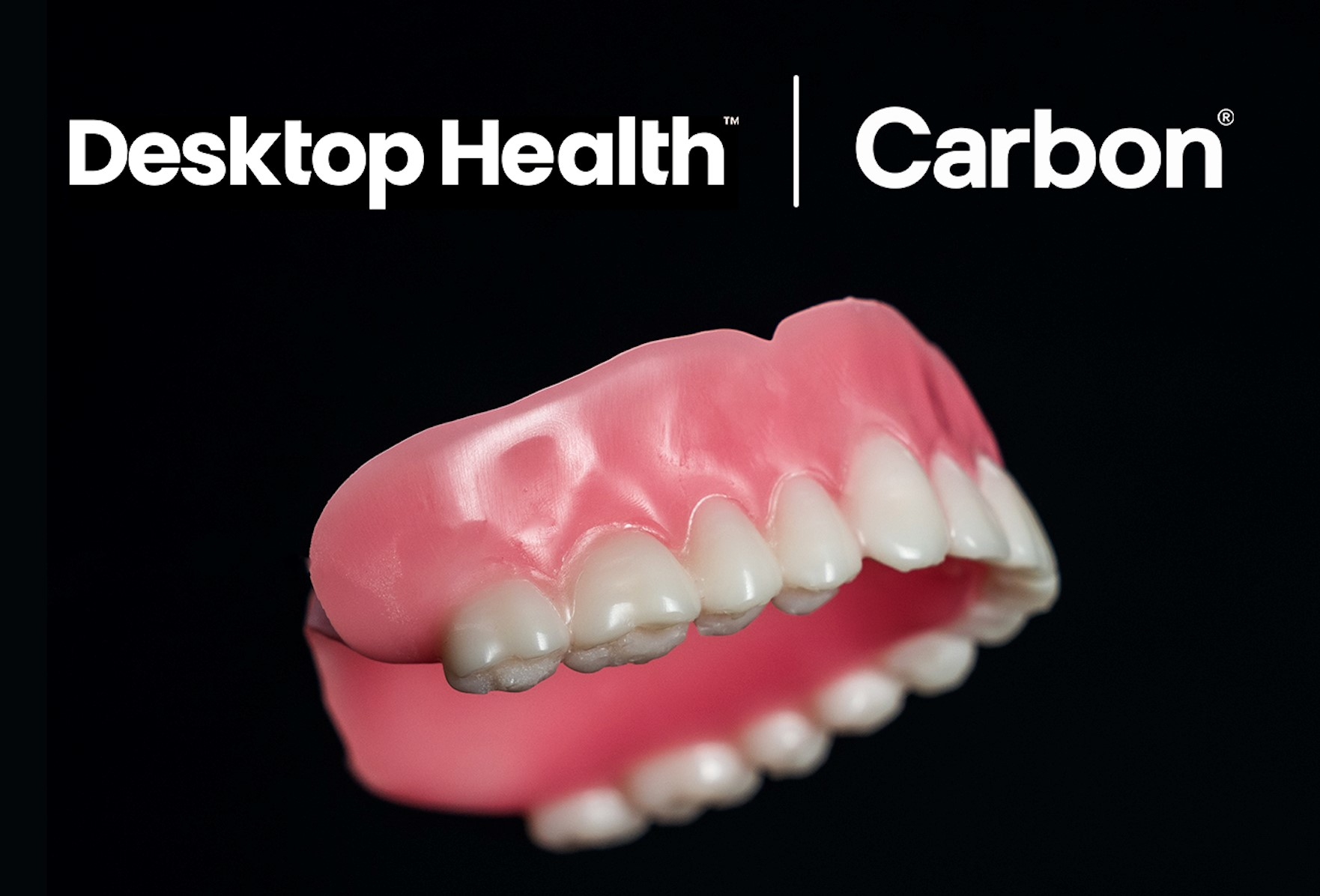

The first Flexcera nanoceramic resin validated for Carbon systems is Desktop Health’s Flexcera Smile Ultra+, an FDA 510(k) cleared Class II material for permanent, 3D-printable dental restorations.
Desktop Health, a brand of Desktop Metal, and Carbon, two leaders in the oral health additive manufacturing space, have joined forces to bring the Flexcera family of resins to the Carbon Digital Manufacturing Platform. This collaboration opens access to the nanoceramic resin, starting with Flexcera Smile Ultra+, for use in 3D printing permanent dental restorations. The Flexcera Smile Ultra+ resin, along with the upcoming release of Flexcera Base, represents a significant advancement in digital dentistry, providing exceptional strength, life-like aesthetics and long-term performance.
The development of Flexcera Smile Ultra+ is the result of more than three years of research and development. The proprietary formulation of the resin features synthesized long-chain chemistry, which is polymerized using a high-powered 385 nm wavelength. This process creates tightly cross-linked polymers that possess ceramic-like strength and life-like aesthetics, making it ideal for 3D printing both temporary and permanent dental prosthetics.
