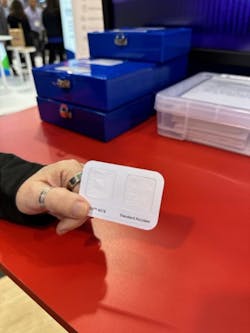

A new adhesive unveiled at the show, 3M Medical Tape 4578, can stick to the skin for up to 28 days. It is intended for use with an array of sensors, long-term medical wearables and health monitors such as glucose and heart monitors.

The medical tape is made of non-woven fabric, consisting of a white spunlace polyester nonwoven backing and coated with a pressure sensitive acrylic adhesive. The primary application of the tape is adhesion to the skin, particularly for healthcare medical devices.

Attendees to the 3M booth were able to sample the medical tape, along with other 3M product demonstrations.
