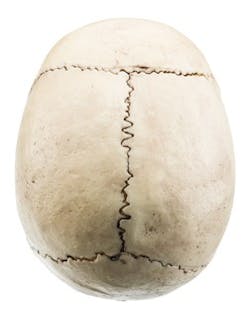

The sagittal planes, also called median or lateral planes, slice the body vertically from left to right. Technically, “the” sagittal plane goes right through the middle, dividing the body into right and left halves. It is named after the sagittal suture, the line running along the top of the skull marking where the left and right halves grew together during infancy. Planes parallel to “the” sagittal plane can be identified as parasagittal planes.
The coronal planes, or frontal planes, divide the body vertically into front (ventral or anterior) and back (dorsal or posterior). They are named for the coronal suture that marks where the skull’s two parietal bones grow and meet the frontal bone.

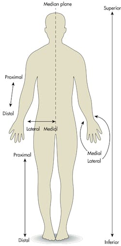

There are a whole host of terms used by healthcare professionals and biomedical engineers to describe anatomical positions. Here are explanations of three pairs of anatomical opposites. (Note: They all apply to a standing human body.)
Medial and lateral: Medial refers to being toward the midline of the body or the median plane, which splits the body, head-to-toe, into two halves: the left and right. Lateral is the side of the body or part of the body that is away from the middle. So arms are lateral to the torso while the torso is medial to the arms. And the medial side of the knee is the inside part or side nearest to the other knee, while the lateral side of the knee faces away from the center of the body and is farthest from the other knee.
Superior and inferior: These terms reference the body’s horizontal vertical axis (the transverse [plane) , and a body part higher than another or above it is said to be superior to it; conversely, the other body part is inferior to or below the first. So, the head is superior to the neck, the neck is superior to the torso, and the torso is superior to the legs.
