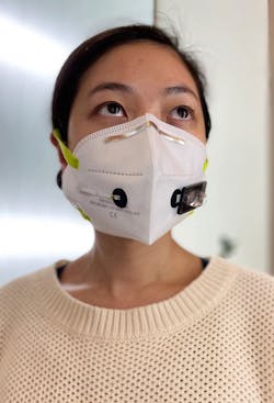

Biosensor-Embedded Face Masks
Reported in Nature Biotechnology, a research team from the Wyss Institute for Biologically Inspired Engineering at Harvard University and the Massachusetts Institute of Technology have succeeded at embedding biosensors into standard-issue face masks, creating an on-the-go testing tool that can be customized to detect pathogens and toxins and alert the wearer.
The button-activated biosensors consist of three different freeze-dried biological reactions that are sequentially activated by the release of water from a reservoir. Once activated, results are available in 90 minutes at levels of accuracy comparable to PCR (polymerase chain reactions) diagnostic tests. The feat of embedding the wearable freeze-dried cell-free (wFDCF) technology into a face mask is the culmination of three years of work and are a stellar practical application.
