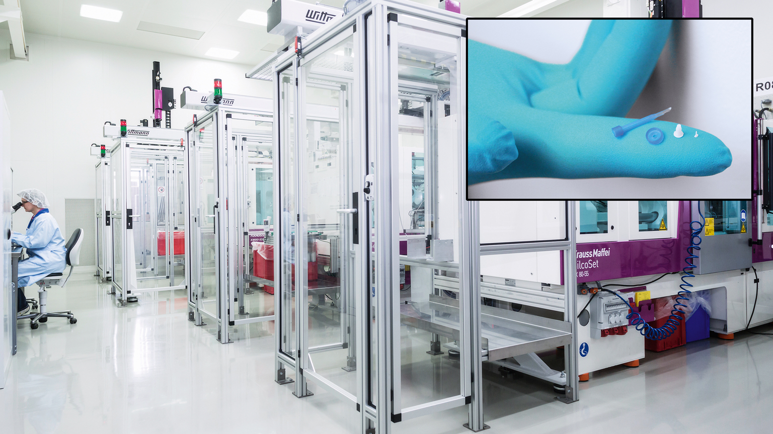

The LSR molding process is well-suited for miniature parts. It can produce micro- and nano-sized components below 10 milligrams in weight through needle-point injection technology. One of the smallest pieces manufactured by LSR molding is a septum, the membrane in the cap of a medicine bottle through which a syringe is inserted and withdrawn. This typically weighs just 0.003 grams. At that size, you can hardly pick the part up, and the standard molding burrs are larger than the part itself.
Manufacturing a micro-component such as this requires extreme accuracy in tool construction, control of shot weight and the molding process. After molding, automatic handling of the product is performed by a specially developed robot gripper arm. The process ensures reliability and accuracy for millions of shots.
The example of the septum shows that automation is critical for medical device component manufacturing. This makes the high-volume production of extremely complex multicomponent LSR geometries possible. Automation can also help ensure cleanliness requirements are met by reducing the risk of contamination during the production process.

Though standards vary, cleanliness in medical device manufacturing is always vital. For some medical devices, production in an “uncontrolled environment” is clean enough. However, due to the nature and positioning of LSR moldings within a medical device, they may need to be manufactured and packed in a fully “controlled” cleanroom of class 100,000, ISO 8 or class 10,000, ISO 7.
Though they’re not generally a sterile environment, cleanrooms control a specified number of particles per cubic meter, at a maximum specified particle size. This includes environmental pollutants, such as dust, airborne microbes, aerosol particles and chemical vapors.
