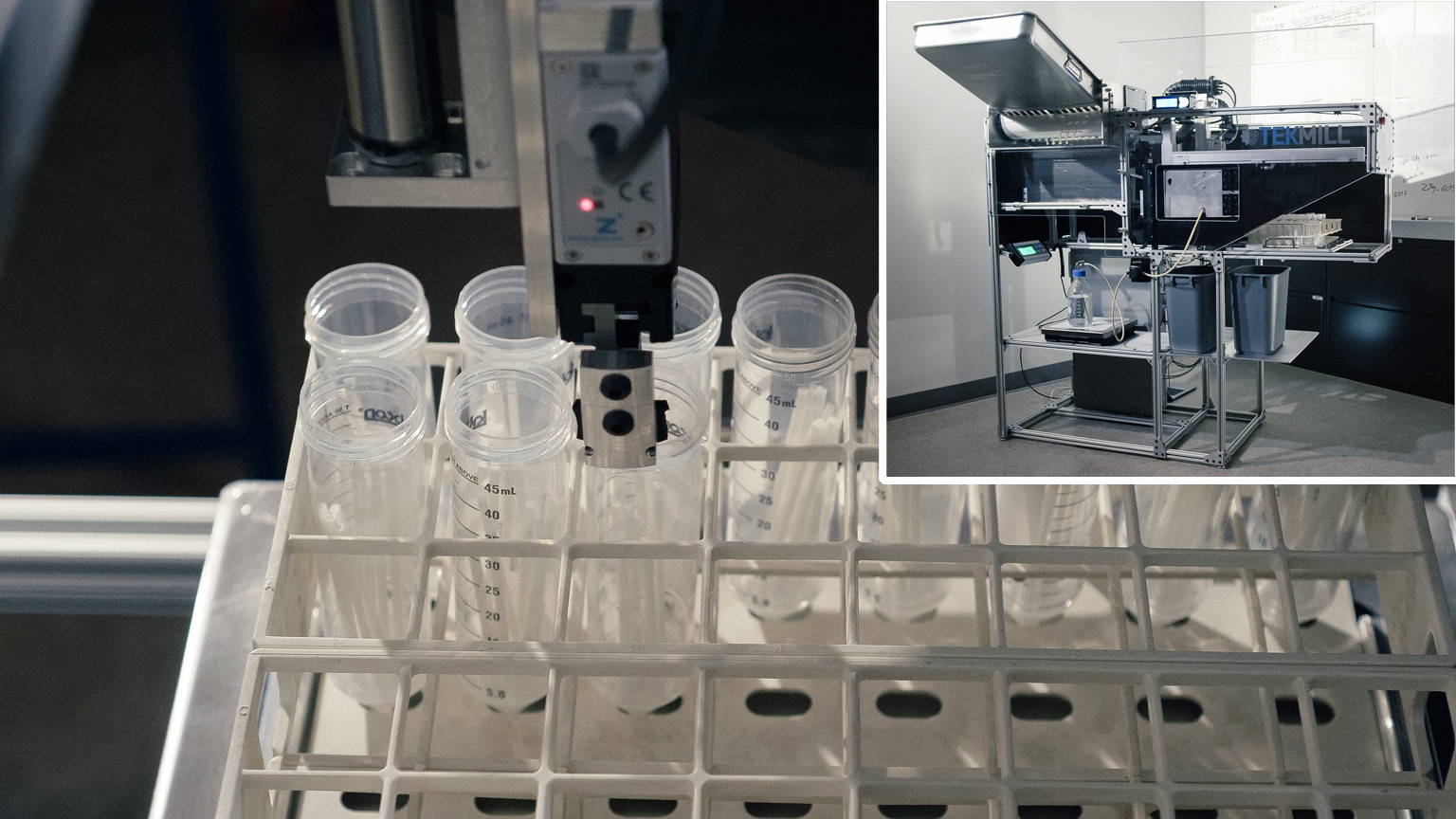

Tekmill, a contract design and fabrication company located at the University of Illinois in Research Park had already developed an automated 50-ml conical centrifuge tube handler for decapping, adding reagent, recapping and placing the 50-ml tubes into a standard test-tube rack of 24 tubes. It freed up skilled lab workers who would otherwise spend hours manually taking caps off, pipetting reagent, placing caps back on and then racking thousands of 50-ml tubes.
The machine was reliable and fast, with a throughput of over five tubes per minute. It delivered reagents with an accuracy of ±3% error for volumes less than 3 ml. The device included a temperature-controlled reagent compartment, quick change-and-clean features, a peristaltic-based pump for sterility and accuracy, and a display screen-based user interface.
The automated machine was compact and could be easily wheeled to where it was needed. It was also flexible, thanks to the EXCM mini-gantry robot from Festo, a global company that designs electrical and pneumatic automation equipment. The gantry robot raised the cap as the test tube was spun, lowered the cap as the tube rotated the opposite way after filling and then placed the test tube in the rack. The robot could easily be reprogramed as conditions changed.
The first step in pooled testing is decapping the tubes and accurately adding reagent. The Tekmill machine could already do this, but not at the targeted rate of 10,000 tubes per day. With support from Festo, Tekmill electrical and mechanical engineers began a rapid redesign to revamp the machine’s robotic gantry.
One of the first tasks was to redesign the cap handling. In the original machine, a test tube was rotated while the Z-axis on the mini-gantry robot used its parallel gripper to hold the cap as it came off the test tube, and later held and lowered it as the tube swiveled closed. After the redesign, the robot no longer removed the cap, added reagents and then put the cap back on. Instead, it removed the cap, dropped it into a newly added disposal bin and then added reagent.
Although machine vision and barcode reading and tracking were not required on the original redesign of the machine, Tekmill engineers wisely planned for this upgrade should it ever be needed. This pre-planning saved time and effort when a vision subsystem and barcode reading were added to the pooled testing machine to track samples and lower the risk of errors. Fluid handling in the original machine migrated seamlessly to the new one, including the benefits of keeping the reagent sterile by using a peristaltic pump.
During testing of the new machine, dubbed the COF-CTV, it was noted that some tubes arriving to be capped were over-torqued to the point that the caps could not be removed without damaging them. Tekmill installed torque sensors to identify over-torquing. When offending tubes are encountered, the mini gantry moves them to a bin designated for manual opening. This preserves the integrity of the 10 samples in the offending tube while maintaining the speed of the other tubes through the unit.
Tekmill engineers also increased the per-load capacity to more than 400 test tubes, which means it only needs to be loaded once per hour, an efficient use of lab staff. The flexibility of the EXCM mini-gantry robot made this transition in speed and quantity a matter of programming. Overall, the upgrades increased throughput from old to new machine by about 20%.
