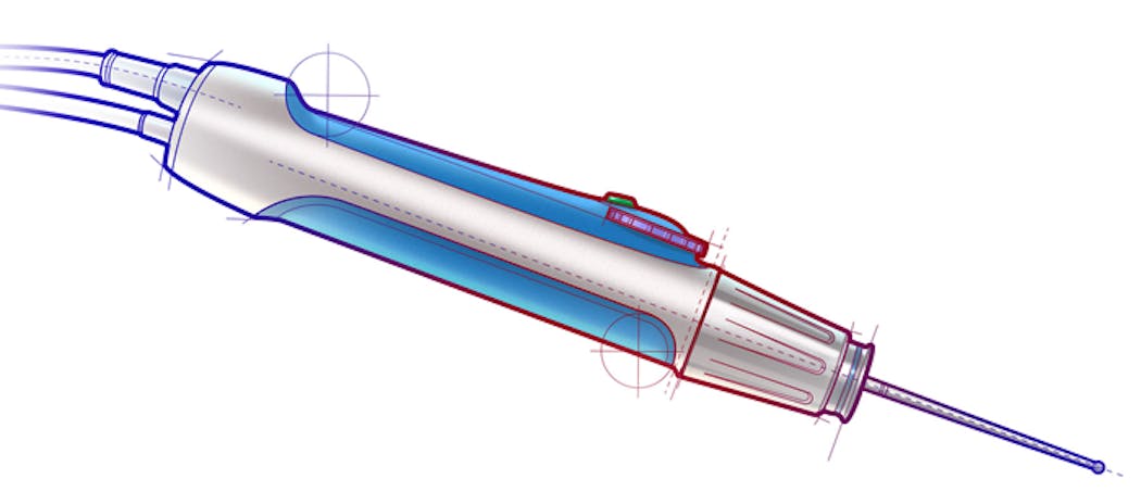

Powered, reusable surgical tools are popular among surgeons thanks to their ability to reduce procedure times and improve patient outcomes. While an array of sensor, feedback and control components makes such advances possible, these parts are prone to corrosion from saline, steam sterilizations and other contaminants.
To ensure reliable performance over years of surgeries and reuse, device OEMs need to protect their tools against moisture ingress. Longer service life and failure-free performance can help lower the average cost per surgery and help justify the device’s sophistication.

Often the root cause for the above failure points is moisture ingress at the distal end of the tool. One way to prevent this situation is to apply a dynamic seal between the handpiece chassis and shaft of the motor. The dynamic seal is designed to provide a sharp seal lip that is held by an internal spring against the shaft. The seal is made from a special polymer blend designed for temperature and wear resistance. The seal assembly includes a mechanism—such as a stainless steel locking device, O-ring or axially compressed flange—that prevents the seal from rotating.
Designers should control runout and surface finish to ensure the seal is tight and long-lasting. Although the shaft seal can prevent moisture ingress at the shaft, it is not infallible. The seal lip and shaft surface will eventually wear, so plan for moisture to ultimately get past the seal. In addition, seals create friction and increase the tool’s running temperature.
Besides the distal end of the tool, mating points on the motor housing—such as between a motor and gearhead—are also susceptible to moisture. These ingress points can be sealed via a hermetic laser weld, sealed threads or O-rings. Other possible entry points are the electrical connections to the motor. The most effective approach to create a reliable design that withstands moisture and liquids is to work closely with the motor designer.
