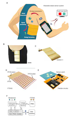

The project resulted in a highly robust, mass-producible, and battery-free wearable platform that efficiently extracts power from body motion through the FTENG-based, flexible printed-circuit board (FPCB). The completed unit is an efficient, wearable low-power wireless sensor circuitry plus a microfluidic sweat sensor patch on a single FPCB platform that can dynamically monitor key sweat biomarkers such as pH and Na+, and generate a relatively high power output of about 416 mW/m2 (Fig. 1).
1. Battery-free FWS3 for wireless and noninvasive molecular monitoring. (A) Schematic illustrating the FWS3 that integrates human motion energy harvesting, signal processing, microfluidic-based sweat biosensing and Bluetooth-based wireless data transmission to a mobile user interface for real-time health status tracking. (B and C) Optical images of an FPCB-based FWS3, which can be worn on a human side torso. Scale bars, 4 cm. (D) Schematic diagram of the FPCB-based FTENG with a grating slider and an interdigital stator. (E) Schematic diagram of the FWS3 showing a microfluidic-based sweat sensor patch interfacing with the flexible circuitry. (F) System-level block diagram showing the power management, signal transduction, processing, and wireless transmission of the FWS3 from the FTENG to the biosensors, then to the user interface. (Source: Yu Song, California Institute of Technology)

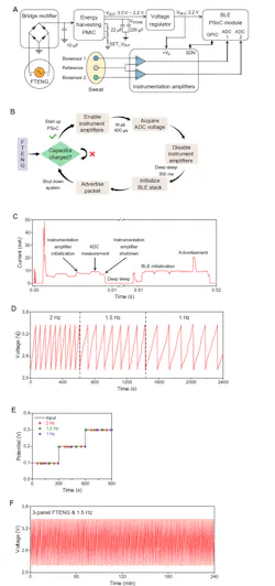

The schematic diagram of the circuit and the high-level flow chart of the operating firmware shows the interconnection and interplay among the many elements (Fig. 4).
4. System-level integration and evaluation of the FWS3. (A) Schematic diagram of the battery-free FWS3 consisting of an FTENG module, a biosensor interface, instrumentation amplifiers, an energy-harvesting PMIC, a voltage regulator and a BLE PSoC module. (B) Operation flow of the FWS3 with signal processing and data transmission. (C) Power consumption of the FWS3 during the operation. (D) Real-time potential of the capacitor (242 µF) during the continuous operation of the FWS3 with a three-panel FTENG under different working frequencies. (E) Validation of data transmission from an FWS3 with a three-panel FTENG under different working frequencies. (F) Long-term stability of the capacitor charging process when an FWS3 operates under a working frequency of 1.5 Hz. (Source: California Institute of Technology)
