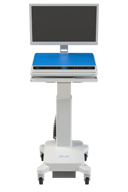

A common theme for medical devices integrated onto mobile workstations is a portable power source for uninterrupted power when mobile. Figure 1 shows an example of a leading medical workstation, manufactured by Simplifi Medical. Similarly, if you walk the aisles of a distribution center (DC) for a large retailer, you will see mobile technology carts typically outfitted with IT devices that require uninterrupted power for continuous operation.

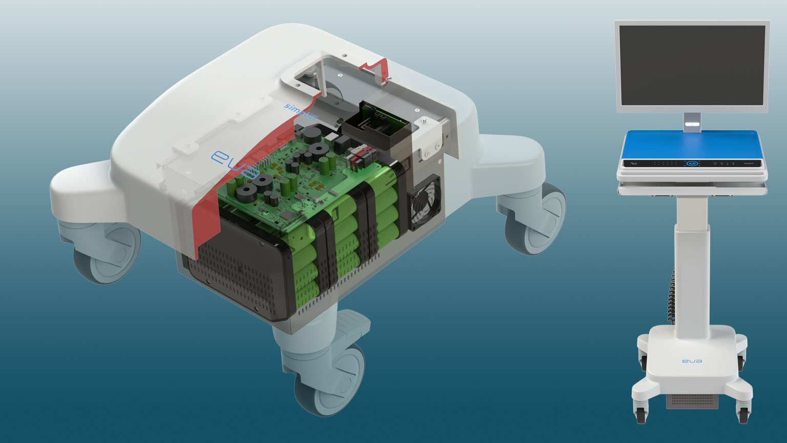

Figure 2 provides an interior view of a medical workstation with in-base power subsystems—the battery and inverter/charger. An in-base power architecture has the following characteristics:
  • Reliability: This architecture has a permanent hardwired cabling system.
  • Nonintrusive operation: This architecture is nonintrusive, and all of the equipment is hidden in the workstation base.
  • Larger capacity: Given the physical capacity in most workstation bases, this architecture can accommodate large batteries to support multiple shifts.
  • Stationary charging: Once the battery is depleted, this architecture dictates that the workstation be plugged into an ac outlet to recharge the battery, which could take up to three hours. Therefore, the workstation is tethered and stationary while charging.

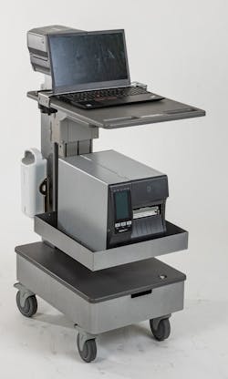

A swappable battery system typically consists of a 12-V, 20-Ahr, 240-Whr Li-ion battery and a 100- to 150-W inverter/charger. Most workstations are designed to accommodate one or two batteries. Figure 3 shows a swappable battery mounted on a leading industrial workstation, manufactured by Definitive Technology Group.
