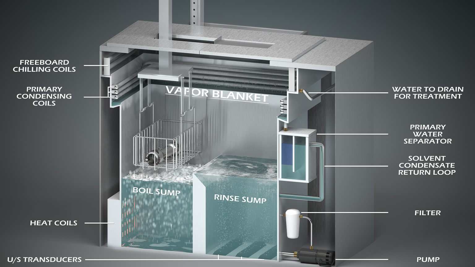

Solvent-based cleaning cleans, rinses and dries parts in just one step inside a single machine. Parts are placed inside a vapor-degreasing machine filled with a solvent-based cleaning fluid.  Most solvent-based cleaning fluids are a mixture of compounds that can include hydrocarbons such as mineral spirits, isopropanol and ethanol. How the compounds are combined determines the cleaning fluid’s effectiveness and its material compatibility. The vapor degreaser can use just one type of cleaning fluid or can be mixed, blended or custom formulated to remove a specific soil from a specific substrate, maximizing cleaning effectiveness.
Parts are immersed in the continuously filtered and distilled cleaning fluid to dissolve the soils from the parts surface. In some instances, ultrasonic agitation is added for additional cleaning muscle. No additional detergents or additives are needed to dissolve the soils. As the parts are removed from the cleaning fluid, they undergo a brief vapor rinse and drying process. The cleaning fluid condenses and drips back into the vapor degreaser to be reused. The vapor degreaser reuses and recycles the cleaning fluid hundreds of times before it needs to be refreshed or replaced. This helps reduce the cost of hazardous waste removal. The parts come out clean, rinsed, dried and ready for the next stage of production.
Since the cleaning, rinsing and drying are done in one machine, the vapor degreaser cleans a high volume of parts quickly (about 6-20 min.). Plus, the cleaning fluid boils at a lower temperature with less heat than the water in an aqueous system. This translates to greater safety for sensitive parts. The parts also require less drying time, which means less energy usage. Solvent-based cleaning also leaves no residue and dries without stains or spots.

Parts geometry helps dictate which cleaning method is preferred. For example, if a company is cleaning miniature, intricate steel parts with tiny blind holes that are subject to corrosion, then aqueous cleaning might not be the best option. Not only could it be difficult to remove the contaminant out of the tight spaces, but the water may also get trapped inside the parts. Even with adding heat and extensive drying, there is a real risk of water getting trapped and causing corrosion. Therefore, in this particular instance, solvent-based cleaning is a better option.
Solvent-based cleaning fluids have a lower surface tension and are less viscous than water. This means the liquid solvent and the solvent vapors more readily get into—and even more importantly, out of—blind holes and any gaps between stacked parts. Solvents are better at wetting part surfaces and evaporating out of tight spaces.
