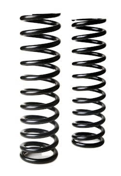

2. A common compression spring can carry different loads by altering a coil’s diameter, length, and number of coils, which can be changed in real time with CNC coiling machines.
With so many possibilities when it comes to making springs, various machines are used to ensure each one is created exactly for its required function. The majority of springs are created on a CNC (computer numerical control) machine. For instance, the KCT680 CNC coiling machine is used to manufacture compression springs, whereby the user can alter the size, number, and diameter of coils, as well as the distance between each coil.
