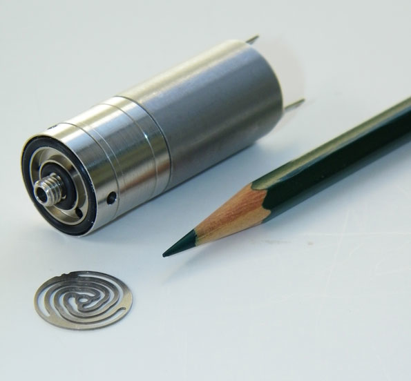

The DV is a high-flow solenoid valve built to last more than 1 billion cycles. An unusual spider spring shifts the valve when the solenoid deenergizes and has a stroke of only 0.018 in.

The engineering team also made extensive use of SolidWorks FEA tools in designing and analyzing the “spider,” an unusual spring that shifts the valve when the solenoid deenergizes. It measures only 0.020-in. thick by about a half inch in diameter, yet generates sufficiently high force with little movement — the DV has only 0.018 in. of stroke. Minimal stroke is necessary, says McBreen, to ensure precise control and maximum flow at operating frequencies as high as 32 Hz.
