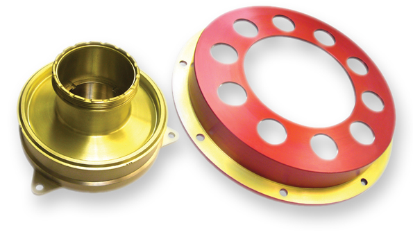

These low-pressure burst discs are for fueling systems in aircraft. They both protect against pressure surges and are compatible with jet fuel. Burst discs for aerospace applications are made of aluminum, stainless steel, superalloys, PTFE, and other materials compatible with jet and rocket fuels, oxidizers, and other harsh fluids.
