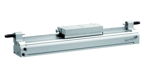

These compact-style actuators can be beneficial when space limitations become a main concern.

Rodless-type actuators are also available in different design styles. A large benefit of the rodless-type actuator is that it saves up to 50% of weight and space when compared with the rod style. The downside to rodless-style actuators is that they are limited when it comes to mounting.
Rodless-style actuators include:
• Single profile barrel and cartridge design – Inch and metric
• Single profile barrel and cartridge with external bearing rail design – Inch and metric
• Magnetically coupled single barrel design – Metric
• Magnetically coupled external guide design – Metric

Benefit Summary
Rodless actuators offer the benefits of reduced weight and a smaller profile. They also have the ability to counteract offset loads.
Rodless actuators offer a reduced weight and smaller overall profile compared to the rod-style actuator. The rodless-style actuator has the added benefit of guide bearing to counteract offset loads. A disadvantage would be the fixed mounting or lack of pivot. However, with some modification, its mounting plate could be made to pivot.
Most rodless cylinders, regardless of manufacture, have a slight leak path due to the piston/cartridge assembly. As a result, they are not the best for load holding applications. Air-bellow actuators are a good option for applications that require a low profile plus high force capability with the ability to arc to the required position.
