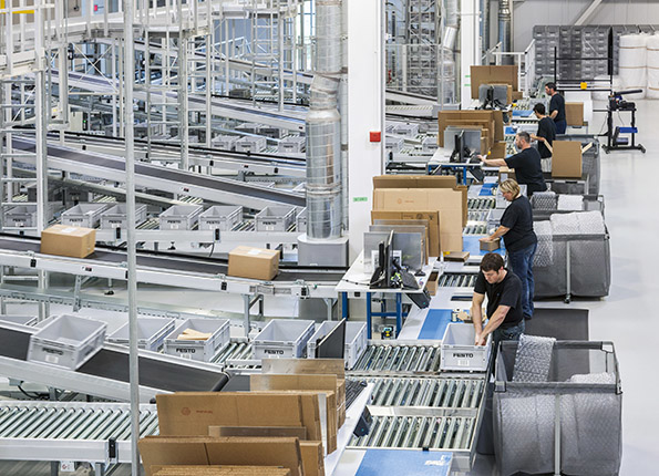

What set this Regional Service Center apart from other facilities in North America is its highly automated order picking system. (Photo: Festo)

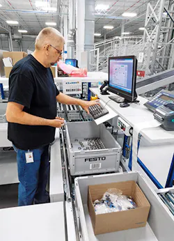

The RSC in Mason will serve has a hub for the United States, Mexico, and Canada for Festo products. The facility has a storage capacity of 65,000 bins and is completely automated. The Witron company implemented the automation used inside the warehouse to prepare products for delivery. Witron designed how the bins are stored, retrieved, and delivered to each of the picking stations. The 10-aisle automated storage retrieval system has 73,000 bin locations and is designed for a variety of tote sizes. A conveyor system delivers the bins to the picking stations. Each picking station, besides having an integrated computer system, has a pick-by-light system and integrated weight scale to ensure a high pick quality. Each workstation can pick up to four customer orders at the same time. The light flashes over the correct bin per order and the scale measures the bin ensuring the correct number of pieces per shipment. The bin is then transported back on the conveyor to packaging and shipping. The system makes it possible to pack up to 10,000 order lines without any errors.
The facility is also the assembly site for many customized parts. The RSC integrates assembly into the warehouse, providing direct access to components. This helps minimize the wait time for customers to receive parts by cutting down on additional supply chains. The customizable products assembled at the RSC include: pressure switches, custom cylinders, valve terminals, cylinder/valve combinations, valve manifolds, semi-rotary drives with ball valve, and sensor boxes.
The automated warehouse system enables the processing of large order volumes. With storage capacity of 65,000 bins and the high performance picking and packing stations the system enables Festo to pick and pack more than 1,000 items per hour.
