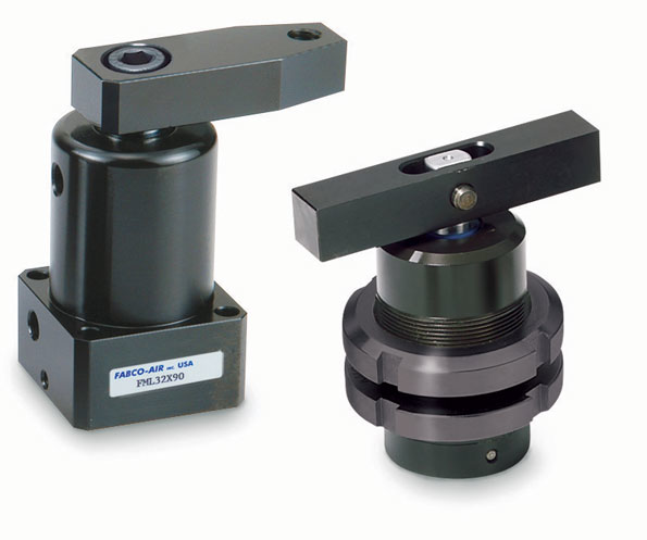

Double-acting pneumatic and hydraulic swing-clamp cylinders have single or double-sided clamp arms with CW or CCW rotation. The clamp arm extends straight up as it releases workpiece, then rotates 90° providing easy access for loading and unloading. During clamping, the arm rotates 90° back, then retracts straight down to the clamp position.
Double-acting pneumatic and hydraulic swing-clamp cylinders have single or double-sided clamp arms with CW or CCW rotation. The clamp arm extends straight up as it releases workpiece, then rotates 90° providing easy access for loading and unloading. During clamping, the arm rotates 90° back, then retracts straight down to the clamp position. The clamps come in five bore sizes (25 through 63 mm) in threaded-body or square-base mounting styles. Maximum operating pressures are 100 psi for the pneumatic models, and 1,000 psi for the hydraulic models. Request Catalog #FML.H.
