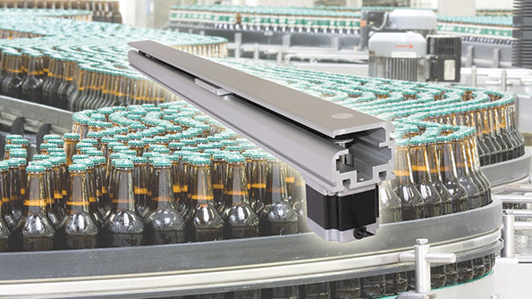

Parker's VLB actuator is engineered with a labyrinth-style frame to mitigate liquid ingress. It also has a rugged timing-belt drive and hardened roller wheels to withstand harsh environments.

If an OEM needs a low-cost actuator, and it must function in a harsh environment, a timing-belt drive coupled with a roller-wheel guidance system can prove to be a robust combination. Assemble these components into a corrosion-resistant housing and design the body such that it limits ingress of fluids and contaminants. The result will be a motion system that provides maintenance-free operation for many years.
