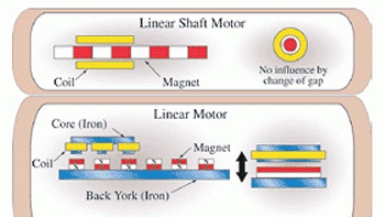

When the flat iron core motor (bottom) was introduced, it was more efficient than alternate forms of linear motion systems. However, in time, tubular linear motors (top) have proven to be much more efficient, producing far fewer eddy currents and eliminating cogging issues.
Linear motor evolution
Linear motors are sometimes described as rotary motors cut open and rolled out flat. In fact, some of the first linear motor designs are just that. When the iron core “flat linear motor” with this design made its debut, it earned market share as a powerful and efficient alternative to other forms of linear transmission systems. However, its efficiency is limited by losses caused by eddy currents and cogging, which in turn limits this motor's suitability for high-precision applications.
Next, the coreless (U-shaped) linear motor was developed to address the iron core motor's problem areas. The “U” has its own advantages and drawbacks: The innovative U-shaped design addresses the losses from eddy currents and cogging, but can introduce lower motor stiffness and greater heat generation, which limits its use in ultra-high-precision applications.
For these ultra-high-precision uses, linear motors first appeared to be the Holy Grail of motion control, offering the promise of infinite positioning options and super-high efficiency. However, in some arrangements, heat from the motor's inefficiency is channeled directly to the work point. This increases the amount of work the linear motor is able to perform, but thermal growth caused by the generated heat complicates submicron positioning.
Subsequently, linear shaft motors were developed. These units consist of a stack of permanent magnets contained in a tube, plus a forcer of cylindrically wound coils. As we'll explore, linear shaft motors are optimized for the most power-efficient linear transmission possible, while also maximizing stiffness.
