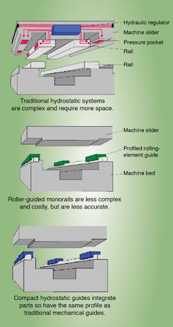

Throughout the machine tool industry, hydrostatic linear guides are considered the best technical solution for vibration damping at the point of system loading. The guides also carry heavy loads and can withstand contaminated environments. However, there was always a catch: Most traditional hydrostatic guides are relatively expensive, time consuming to mount, and require a larger design envelope than conventional linear guides. For these reasons, they're infrequently specified.
Now, newer compact hydrostatic linear guides address old issues. Built to the dimensions of standard profiled-rail linear guides, they fit within the same design space as typical recirculating bearing and guideway assemblies — to give engineers and machine builders the benefit of unmatched damping without requiring installation compromises.

This integral hydraulic control system is what allows the unit to fit into the same standard design envelope as a conventional roller profile rail system.

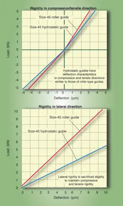

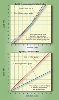

One might assume that moving loads on a film of oil would not provide the rigidity necessary for maximum machine performance. To the contrary, when standard design specifications are met, the tensile rigidity of a hydrostatic linear guide is roughly equal to that of a similarly sized roller bearing and guideway assembly. Note that this is based on a two-rail, four-carriage system with two carriages per rail. With this arrangement, rigidity in the compressive direction is 1,300 N/µm; in tensile and lateral directions, it is 1,200 N/µm and 950 N/µm respectively.
This includes deformation of the hydrostatic guide and screw connections to the adjacent construction. The rigidity of the carriage prevents any deformation of the pressure pockets, which is critical in maintaining equal pressure distribution within the carriage.
Rigidity can also be enhanced by increasing the oil pressure via a valve setting. In mechanical systems, higher preloads on the rolling elements are required to boost rigidity. Unfortunately, what also results is increased rolling friction and an exponential decrease in bearing life.
Hydrostatic carriages, on the other hand, run on pressurized oil, so there is no increase in friction and no effect on the system's operating life. Friction is independent of load until the load limit is reached.

Traditionally, machine builders addressed damping by integrating hydrostatic elements within machine slides. These slides ran on high-accuracy precision-ground ways. This design was very expensive and required a larger design envelope. Another drawback was the high oil loss during operation, which required troughs to recapture the contaminated oil, and the maintenance of a high-end filtration process.
