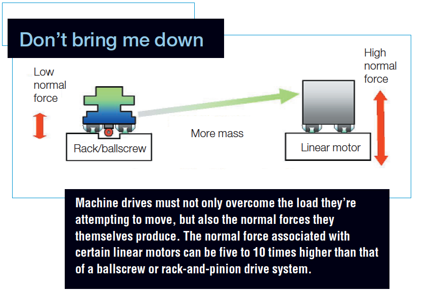

Depending on how they are manufactured, rack-and-pinion drives can deliver very precise motion, rivaling or exceeding that of ballscrews and even linear motors.
Rack and pinions are the other precision linear drive. In concept, they're one of the oldest and most basic power transmission technologies. They consist simply of a pinion gear meshing with a toothed bar or “rack.” Although either component may be fixed, it’s usually the pinion, which when rotating, forces the rack to move laterally in the direction of rotation.
When combined with high-end servo actuators, precision rackand- pinion drives can hold less than 1 arc-min of backlash, true running of 10 μm, and 98.5% efficiency. Such drives are employed in many precision applications, including high-speed metal cutting, laser cutting, grinding machines, and woodworking machines. Other applications include automatic assembly equipment and gantries.
