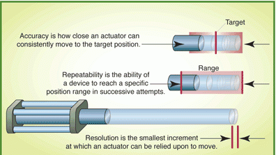

Accuracy
Accuracy has two aspects. First is the accuracy of the actuator itself, determined by the moving element and its ability to travel in an ideal single-axis path or straight line. An inescapable truth: The motion provided by the actuator is only as true as its mechanical components. Actuator accuracy depends on the base or cylinder tube and the bearing or guidance system employed, such as ball bearings or slide bearings.
The second aspect is the actuator's ability to provide increments of precise motion along the working axis, which depends on leadscrew or ballscrew lead accuracy, feedback encoder or linear scale resolution, and controller precision.
Repeatability
Repeatability is the ability of a device to reach a specific location or position in successive attempts. Unlike accuracy, repeatability does not take into account the actuator's ability to travel an ideal axis. In real applications, an actuator often travels through a slightly bowed or twisting path due to the components used in its construction. Repeatability is influenced by the direction of approach to the target point.
For example, approaching the target from the same direction every time means that a unidirectional repeatability tolerance will apply. In contrast, approaching the same target from two different directions means that a bidirectional repeatability tolerance will apply. Bidirectional repeatability also includes the effects of leadscrew backlash, which in some cases will dramatically influence the repeatability tolerance. Note: An actuator may be highly repeatable without being highly accurate.
Resolution
Resolution refers to the smallest positional increment that can be asked of a motion system. Motors, encoders, controllers, and mechanical components act together to define system resolution. For example, a system using a stepper motor and micro stepper drive set (at 2,000 steps per revolution) and a five-turns-per-inch ballscrew gives 0.0001-in. resolution. Although it's possible to select systems with substantially better resolution, tighter resolution is not always practical. Why? Because mechanical limitations — such as friction and nut backlash in bidirectional moves — can render extremely small move commands ineffective.
