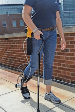

Researchers have developed a pneumatically powered ankle-foot orthosis. A bottle of compressed CO2 worn on a belt drives the portable device.

Researchers from the University of Illinois, Georgia Tech, University of Virginia, and University of Minnesota, working with a grant from the Center for Compact and Efficient Fluid Power, have developed a pneumatically powered PPAFO to provide untethered assistance for daily in-home rehabilitation treatment. According to the researchers, the key advantages of fluid power for this application are the actuators’ high force output in relation to its size and weight; the ability to actuate a joint without a transmission; and the freedom to route pressurized fluid to the actuator through flexible hoses, which lets the actuator be placed in locations not possible with an electric motor. The high force-to-weight ratio and the flexibility to mount components elsewhere on the body let researchers reduce the weight of the device at the shank and foot.
The PPAFO was designed to assist impaired gait by controlling forefoot velocity when the heel hits the floor to prevent foot slap; allowing free range of motion while standing; provide assistive torque for propulsion; and support the foot and prevent it from dropping when the leg swings. It uses a 9-oz bottle of compressed liquid CO2 and a pressure regulator from Supplierpipeline Inc., Waterloo, Ont., to power an SMC, Noblesville, Ind., dual-vane, bidirectional rotary actuator at the ankle joint. The CO2 bottle and regulator are worn on a belt attached to the waist, separate from the structural elements of the PPAFO. This distributes the weight and minimizes loads on the lower limbs. A second pressure regulator from Festo Corp., Hauppauge, N.Y.. modulates torque to support the foot during leg swing.
The direction of torque switches from dorsiflexor (toes up) to plantar flexor (toes down) with two Festo solenoid valves. Control of valve switching is based on inputs from force sensors on the foot. The pressure regulators adjust the magnitude and timing of PPAFO torque output to provide the appropriate assistance while walking. Tests used 90-psig pressure to power the actuator, and longevity of the system was rated by running until final pressure reached 20 psig.
Results showed the device significantly aided dorsiflexor movements and, to a lesser degree, plantar flexor movements as the test subject walked. The loaded position-response speed (600°/sec) was fast enough to initiate different PPAFO motions as needed. Test participants reported that the PPAFO provided noticeable assistance that improved gait quality. The novel, portable pneumatically powered AFO lays the groundwork for future studies.

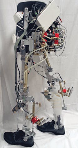

The exoskeleton consists of computer-controlled hydraulic knee and hip circuits. (Photos are courtesy of the Louis Stokes Cleveland VA Medical Center and Case Western Reserve University.)

Paralysis, muscle weakness, and lack of coordination are common consequences of combat-related injuries to the central nervous or musculoskeletal systems, according to researchers at the Advanced Platform Technology (APT) Center in Cleveland, a Department of Veterans Affairs Center of Excellence for Rehabilitation Research and Development. To address these issues, APT researchers are designing and testing bracing systems that lock and unlock in coordination with voluntary or stimulated muscle contractions.
The goal is to restore or assist independent walking and upright mobility. A first generation gait-assist system combines electrical stimulation to the paralyzed lower extremity muscles with a controllable hydraulic exoskeleton. It’s intended to help individuals with spinal-cord injuries stand, walk, and climb stairs.
The system consists of computer-controlled hydraulic knee and hip mechanisms that let the lower extremity joints move during walking, yet be fixed during weight bearing so the muscles can rest. The goal is to improve the stability and posture of individuals with paraplegia as compared to walking with electrical stimulation alone, and also reduce user effort and increase walking speed when compared to standard reciprocal braces.
The project’s next step is to make the exoskeleton self-contained and suitable for independent use and clinical testing outside the laboratory. Researchers are working to reduce overall size and weight, as well as refine the controls to coordinate hip and knee motion and damping under load. The goal is to improve foot-floor and step clearance during walking and stair climbing, and provide smoother and more natural gait and stair descent. If successful, the design may give users better mobility, particularly on uneven terrain.
