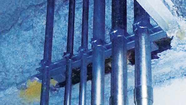

Piping systems are often not self-supporting because of routing, length, and weight factors. Weight loads include the weights of pipes, contents, insulation, valves, fittings, and possibly the supports. Gas, air, and steam lines that require hydraulic tests must also consider the added water weight. Restraining pipe movements from thermal expansion imposes loads on the pipe. Pressure-wave propagation from water hammer generates thrust loads on pipe sections. (See “Taming water hammer,” http://machinedesign.com/news/taming-water-hammer.) Wind can sway outdoor pipes. And earthquakes induce both vibration and differential anchor-movement loads.
Hangers carry weight from above a pipe with the support assemblies in tension.

Hangers carry weight from above a pipe with the support assemblies in tension. A hanger suspends the weight of about half of the adjacent pipe spans, the riser within those spans, and the hanger assembly itself. Hangers must be adjustable while supporting the weight. Adjustment nuts and turnbuckles should have full lengths of thread engagement with locking devices. ANSI coarse threads with Class 2 allowance/tolerance are recommended. Use the root area of the external thread for stress calculations. Hangers need adequate length so that any motion does not impose large horizontal restraining forces on the pipe.
Rigid hangers (or hanger rods) are simple devices that consist of a rod, clamp, and attachment nuts. They’re suitable for pipes with limited vertical thermal movements, such as cooling water pipes.
