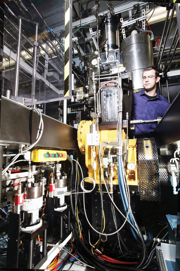

The diesel-engine test bed at Sandia National Laboratory’s Combustion Research Facility is used to study ultrahigh fuel-injection pressures. Two pumps are on the left and the yellow housing contains the crankshaft. Directly above it, the injector and valves mount to the black housing that holds the cylinder and combustion chamber.

To simulate a heavy-duty diesel engine, CRF uses a diesel engine with a single, large-bore cylinder that is fed fuel from two diaphragm pumps at pressures up to 43,000 psi. Inside each pump, fuel and oil, separated by a stainless-steel diaphragm, are pressurized by a hydraulic cylinder. The cylinder compresses the oil, flexing the diaphragm and causing fuel to flow. The dual pumps cycle at 2 Hz, acting 180° out of phase to maintain a set pressure while minimizing pressure spikes. A 6-gpm pump driven by a 10-hp motor supplies the hydraulic fluid.
The Sandia team initially controlled the fuel system manually, monitoring fuel pressures with a gauge and adjusting drive pressure via a hand valve. They found that maintaining a target pressure and changing pressure setpoints proved to be extremely difficult. As an alternative, they turned to electrohydraulic motion control.

To get better precision and stability from the hydraulics, Sandia engineers opted for an RMC75 motion controller from Delta Computer Systems, Battle Ground, Wash. It uses feedback data from a pressure transducer in the fuel line to close the pressure-control loop.
