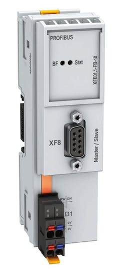

A process fieldbus (Profibus) is a typical automation technology communication. If a line integrates industrial Ethernet (Profinet), a PLC’s modular design allows for easy replacement.
Modular design allows for expandability, which is one advantage of using a PLC. Other advantages include cost, simplicity, and robust design. When replacing older technology such as relays, another benefit emerges in the reduction of moving parts. Integrating a more complex system, such as a PC controller, can add other benefits, but one must also consider the added cost and training.
