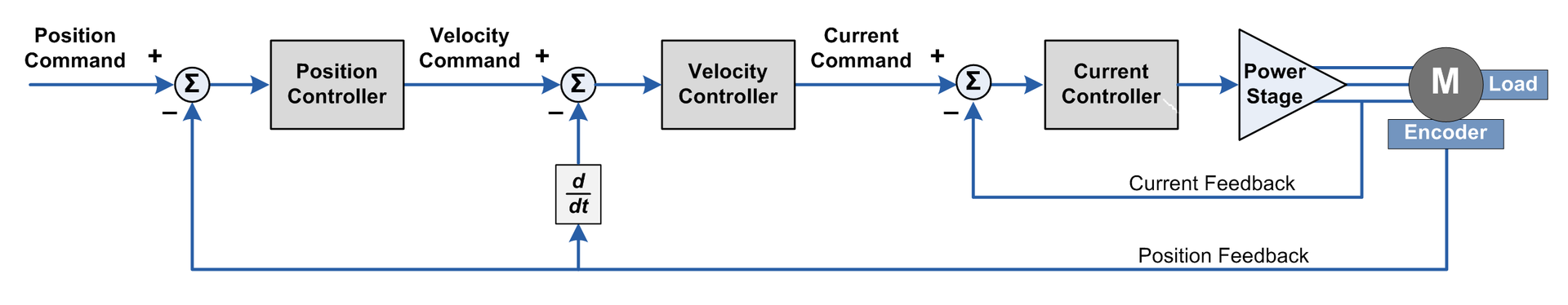

Servo controllers commonly use traditional cascaded configurations in which a velocity loop is nested within a position loop. This configuration originated when current and velocity controllers were hardware, while position control was done using software. Cascaded configurations remain popular because of their simplicity. Engineers first tune the velocity controller then the position controller, with current control parameters usually set automatically. And the position controller is typically a simple proportional coefficient, while the velocity controller includes a proportional coefficient and an integral term.
1. Traditional Cascaded Control Loops
The primary drawback of this configuration is an intrinsic tracking error during movement that is proportional to the speed of that movement. You can reduce this error with feed-forward methods, but at the expense of an overshoot or a longer settling time.
