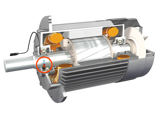

“Intelligent” sensor bearings provide accurate information on speed (rpm), direction, and incremental or absolute position of rotating or linearly moving components. They can generate signals that contains data such as the number of revolutions, relative position/counting, and if they are accelerating or decelerating. These intelligent bearings contribute to productivity and reliability, and allow for more-compact equipment.
This cutaway drawing of an ac motor shows the built-in sensor (Circled; red/blue) that generates speed and position data, which can be used as feedback signals.
In a typical scenario, a sensor gets designed into the bearing. The sensor is often an impulse (or code) ring linked to the bearing’s rotating inner ring. The inner ring contains a sequence of north and south-oriented magnets. The sensor detects changes in magnetic fields as the bearing and its magnets spin and converts those changes into digital signals. Each rotation of the bearing generates a predefined number of pulses or magnetic signatures, which can be decoded in real time as rotational speed and position. If there is too much EMI, the bearing and sensor can be shielded.
Intelligent bearings such as these can serve as motor encoders to monitor position, rotational speed, and direction of motor shafts. They mount inside the motor and provide reliable alternatives to conventional encoders, which mount outside the motor. Variations on this setup include end-of-shaft multiturn sensors, absolute through-shaft sensors, and high-resolution absolute-position sensors for measuring position, and roller encoders for making linear measurements.
