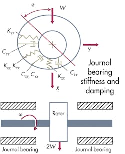

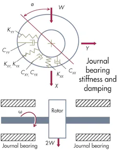

A journal bearing’s stiffness and damping coefficients are shown for an idealized, rigid rotor with weight 2W, supported on two journal bearings.
Now, with normal radial displacement of the shaft, oil pressure on the upside of the close clearance zone will be higher than on the downside. The resulting tangential force in the direction of rotation tends to induce “forward whirl” of the journal. With this whirl, the increasing tangential force reduces the clearance further to produce an increasingly higher destabilizing tangential force. Field experience has shown this whirl frequency is typically less than 2% below half the rotor speed.
Let’s look at some highly simplified features of oil whirl. The graphic, Journal bearing stiffness and damping, represents an idealized rotor of weight 2W supported on two identical bearings. The load on each bearing is W, and the bearing center is displaced to a steady operating position as shown. One can draw a line connecting the shaft and bearing centers, and the load line, to form an attitude angle ø. It’s unique to the bearing and operating condition.
In general, the lowest natural frequency is No = ωo/2π, where ωo = (k/m)0.5 with k representing shaft stiffness and m the rotor mass. While the equivalent spring constant for vertical displacement is not linear over any extended range, a value KXX can be taken as the differential displacement in the vertical direction (X) with a differential change in W (as with a rotor imbalance or varying external force). With no rotor flexibility and negligible damping, the bearing vertical natural frequency becomes, as for any simple spring-mass system:
The first subscript of KXX indicates that the weight, W, produces a force in the X direction; the second subscript indicates that this K is for motion in the X direction. KXY is the spring constant related to displacement in the oil film in the Y direction under a force in the X direction.
Because a softer spring constant KYY is encountered in the unloaded horizontal direction, the bearing horizontal natural frequency becomes:
Similarly, one can define damping coefficients CXX and CYY in the vertical and horizontal directions. For other than pivoted-pad bearings, cross-coupling coefficients must also be introduced (KXY, for instance) as a spring constant for motion in the Y direction, for varying vertical load W in the X direction. Forces induced by the cross-coupling coefficients tend to drive the rotor into an orbit. Typically for light loads in fixed-arc bearings with cross-coupling, this orbit frequency is close to half the journal rotational speed.
If damping and load are not sufficient to suppress this cross-coupling force, the rotor may break violently into an uncontrolled whirl orbit, or rotor whip, with an amplitude closely matching the full internal clearance in the bearing.

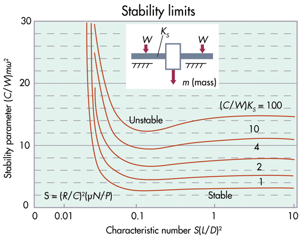

Stability characteristics of a rotor carried on a full 360° journal bearing can be estimated from the Stability limits graph. These results are based on the so-called short bearing approximation valid for bearings with L/D ≤ 1 and apply only for laminar flows.
Greater shaft flexibility (lower Ks) tends to decrease stability. Kscan be approximated from simple beam theory by dividing the rotor weight by the midspan deflection resulting from that weight. (A more-detailed analytical background and oil-film response coefficients for fixed-arc and pivoted-pad bearings are provided by “Journal and Thrust Bearings” by A. Raimondi and A.Z. Szeri; and “Fluid Film Lubrication” by H.J. Sneck and J.H. Vohr. Both can be found in the CRC Handbook of Lubrication, Vol. II, CRC Press, Boca Raton, Fla., 1984.) More-recent computer routines using numerical solutions deal with the effect of temperature on the bearing’s dynamic behavior.

Here’s an example of how to predict behavior. Determine whirl stability for a 5,000-lb horizontal rotor in its cylindrical bearings with the following characteristics: diameter D = 2R = 6 in.; length L = 3 in.; radial clearance C = 0.006 in.;
N = 60  rev/sec (3,600 rpm); lubricant viscosity µ = 2 ×
10-6 lb-sec/in.2 (reyns); and rotor stiffness Ks= 10 × 106 lb/in.
Load or rotor mass m = W/g = 5,000/386 =13.0 lb-sec2/in.
Unit load P = W/(DL)= (5,000/2)/(6 × 3) = 139 psi.
Sommerfeld number S = (R/C)2 (μN/P) = (3/0.006)2 (2 × 10-6 × 60/139) = 0.216.
Bearing characteristic number S(L/D)2 = 0.216(3/6)2 = 0.054.
(C/W)Ks = (0.006/2,500) × (10 × 106) = 24; and
(C/W)mω2 = (0.006/2,500) × 13.0 × (2π × 60)2 = 4.43.
Referring to the Stability limits graph, because the coordinate point S(L/D)2 = 0.054, (C/W)mω2 = 4.43 lies below the curve for (C/W)Ks = 10 and the rotor will be free of oil-whirl instability.
If the speed were raised to 7,200 rpm, however, repeating the above calculations shows that S(L/D)2 = 0.108 and
(C/W)mω2 = 17.72, which falls in the unstable region.
Stability limits are graphed for a single mass on a 360° cylindrical journal bearing, based on an approximate solution. (From A. Raimondi and A.Z. Szeri, “Journal and Thrust Bearings,” CRC Handbook of Lubrication, Vol. II, CRC Press, Boca Raton, Fla., 1984)
