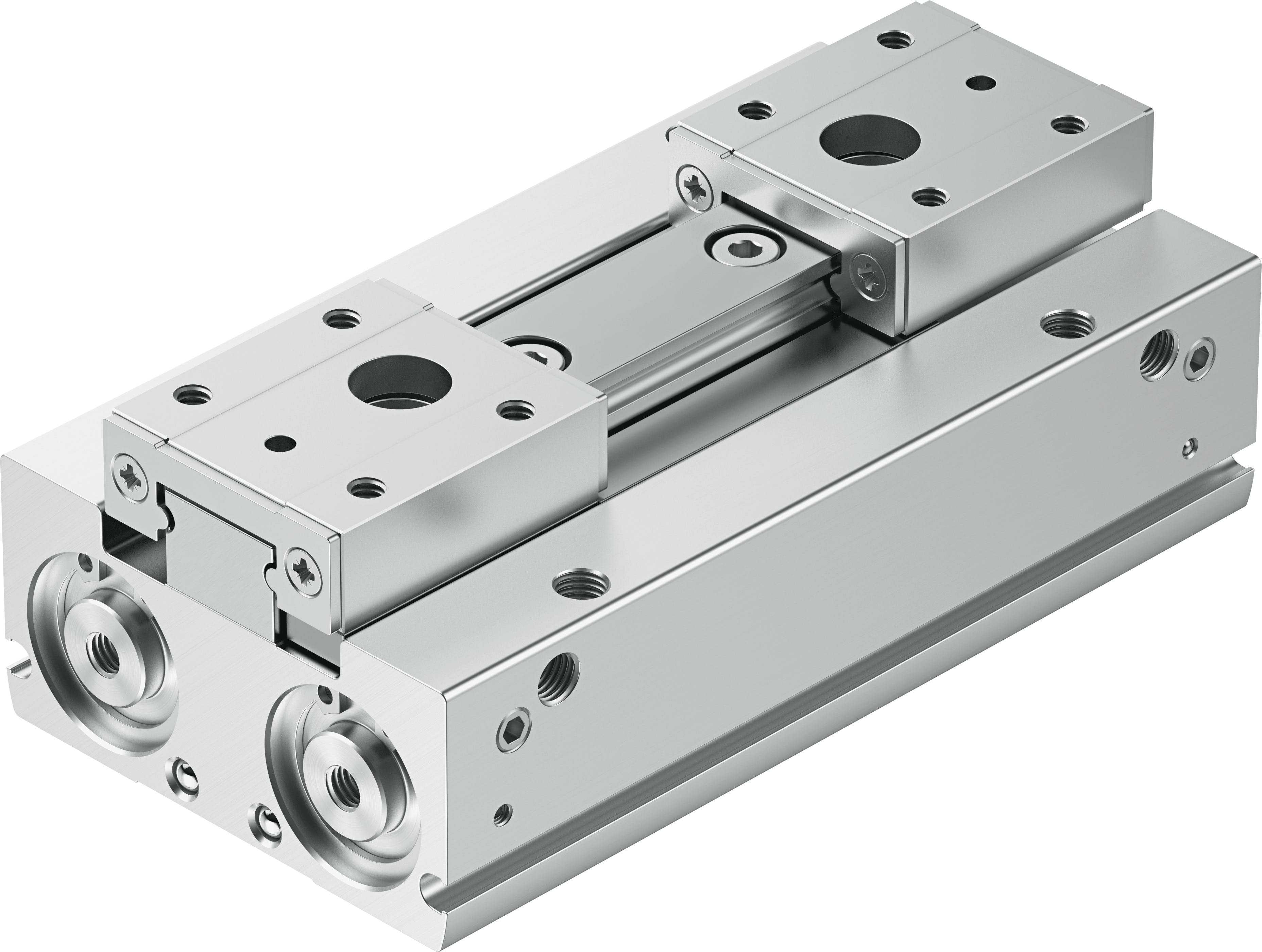

Industry has pushed for smaller footprints and more sustainable machines, and Festo has answered with its HPPF flat parallel gripper for space-constrained applications.
The gripper is designed to address the challenges of space-constrained applications in small parts and electronic assembly, including batteries, and comes in four sizes—8, 12, 16 and 20—with a height range of 19 mm to 41 mm.
Key features of the HPPF flat parallel gripper include:
  • A compact and flat design
  • An integrated guide and robust design for durability
  • Availability in many sizes and strokes
  • Reduced material use and maintenance-free for sustainability.
READ MORE: Festo Launches MS-Basic Line of Pneumatic Service Units | Machine Design
Symmetrical, Flexible and Adaptable
Made with twin piston rack-and-pinion motion and ball-bearing guides, the HPPF grippers ensure high accuracy, with a tolerance level that ranges from ≤0.03 mm to ≤0.06 mm. The compact units also offers maintenance-free service life and a symmetrical design for flexible mounting.
The inclusion of a C-slot for sensors on both sides makes them adaptable. Its low weight ranges from 68 g for the smallest unit to 1,326 g for the largest. Users can adjust the stroke, and there is an option for cushioning. Its stroke range is 8 mm to 80 mm and provides a gripping force from 60 N up to 377 N. Low copper, zinc and nickel content (less than 1%) make it a suitable choice for sensitive electronics applications.
