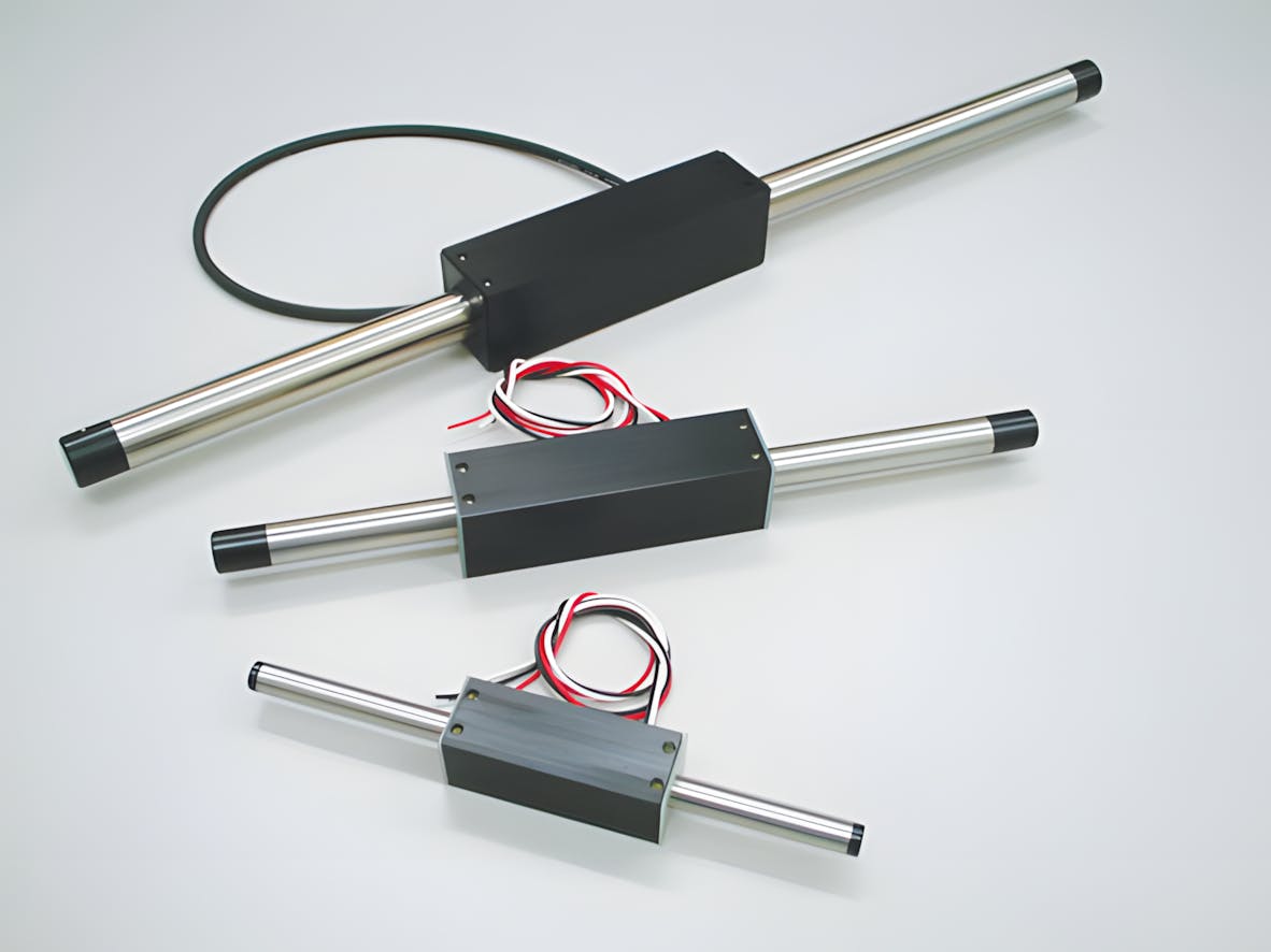

Linear Shaft Motor
For applications sensitive to the effects of heat propagation, linear shaft motors retain the motion dynamics, smooth motion and high precision of U-channel motors but with better heat dissipation, says Robert White, technical sales manager, Nippon Pulse America. That largely comes down to the efficiency of the motor’s design, he says.
Unlike flat and U-channel motors, linear shaft motors are composed of a tubular metal shaft in which cylindrical rare earth magnets are stacked with like magnetic poles facing each other. The ironless forcer and its coils surround and travel along the permanent magnet shaft with a thin air gap between them.
This cylindrical design allows for the entire coil to interact with magnetic flux of shaft in all directions, rather than one side of the magnetic track as in a flat ironcore motor. As a result, shaft motors require less current, and generate less heat, to produce the same amount of force. In addition, a rectangular or cylindrical shaped forcer can also dissipate heat in all directions whereas heat can build up within a U-channel stationary track. Less heat means less potential thermal expansion and contraction, which translates to shaft motors’ exceptional accuracy, White says.
READ MORE: Fresh Off the Line: Six Product Rollouts to Level Up Your Engineering Toolkit
“With a linear shaft motor, you can get down to sub-nanometer and even picometer positioning capabilities,” he says. “It all depends on the feedback device, of course, and bearing systems. In some cases, the only way to get to that level is with an air bearing. But some of the good rails systems these days have really good performance. Every day, we’re selling product that uses half-micron encoders, and we’re getting micron, sub-micron positioning capabilities.”
The major limitation of linear shaft motors is stroke length. While an ironcore and U-channel motor can be as long as needed, White says the length of a shaft motor assembly is constrained since the tubular shaft is only supported at each end of the travel.
“With linear shaft motors, I can get maybe two meters, maybe three meters,” he says. “There are also techniques that you can do to make the shaft stay straight because you don’t want it to sag and touch the sides of the forcer. With shaft motors, I can’t go after eight- or 10 meter-type applications without doing something crazy.”
