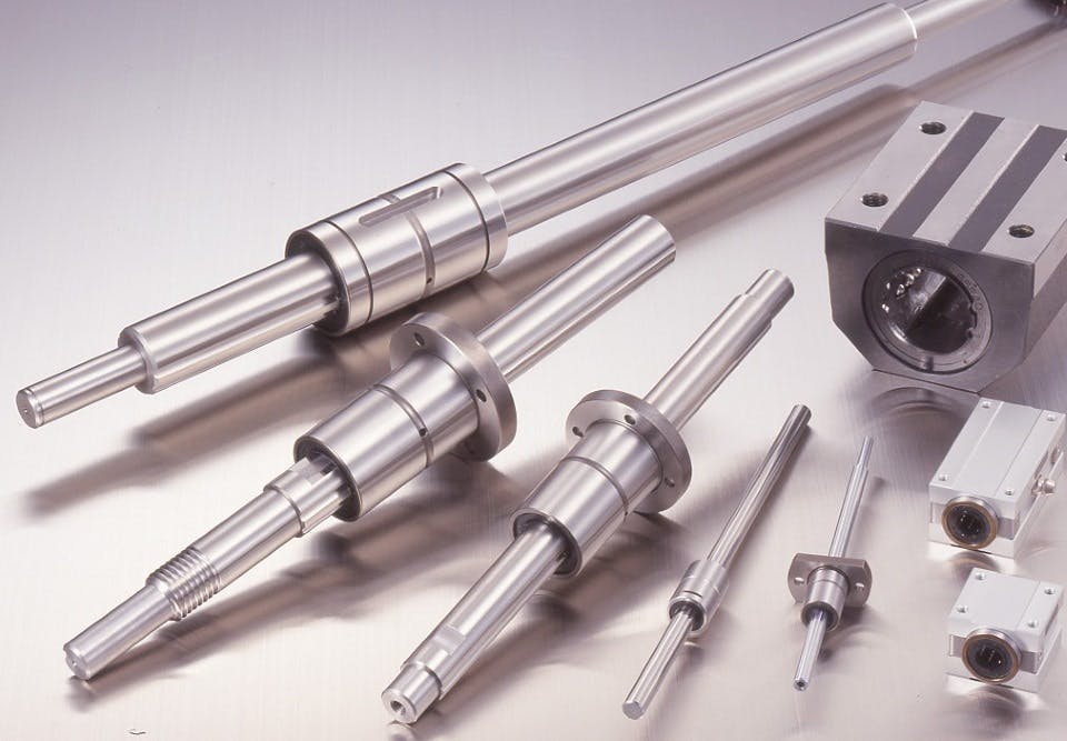

Ball splines are rolling ball elements that are suited for demanding applications. With dual-function capability designed into an integrated system, ball splines simultaneously transmit torque and precise axial movement along a shaft.
Ball splines are sometimes misunderstood in the intricate landscape of high-precision engineering. For one, they can be mischaracterized as fragile, or ill-suited for heavy loads.
But these innovative multiaxis components are designed to be robust and, contrary to misconceptions, technical literature highlights that rolling ball elements enable low friction even under heavy loads.
The first ball spline, developed in 1971 by THK, was a precursor to linear motion guides, which were introduced a year later. Ball splines were designed from the get-go to achieve smooth motion by combining low-friction torque transmission with smooth linear motion in a single mechanism. They consist of an outer cylinder, retainer, side rings and ball elements.
Ball splines achieve distinctive performance by using the rolling motion of ball elements. Contained in a retainer, the balls circulate along one or more machined splines (axial grooves) on the shaft. This design creates a low-resistance pathway for the balls to travel smoothly and efficiently along the length of the shaft.
A properly engineered ball spline enables effective torque transfer and allows smooth linear motion along its axis. This makes it especially suitable for applications that require both rotational and sliding movements under load. Leading manufacturers use high-strength alloy or hardened steel materials that undergo surface treatments to enhance wear resistance and ensure durability throughout the component’s operational life.
Ball splines are well-suited for applications that require both precise linear motion and the ability to simultaneously transmit torque. This makes them ideal in systems where components must slide smoothly along a path while maintaining controlled rotational force, such as in robotics, automation equipment and CNC machinery.
The ball spline’s design ensures accurate positioning and reliable torque transfer under load. Therefore, it serves simultaneously as a linear guide and a shaft that carries torque, all in one design.
