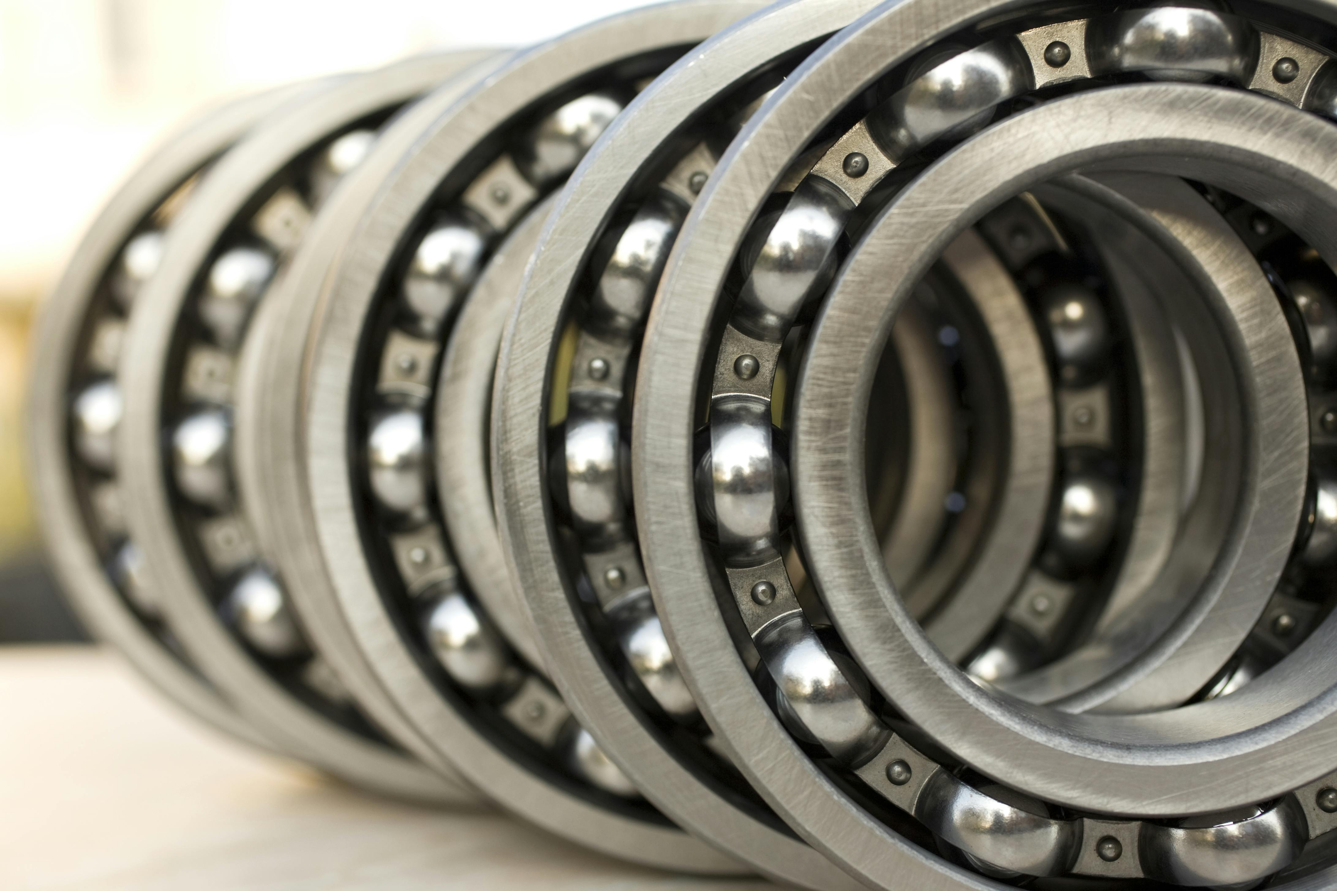

Located between two annular metal pieces, known as races, the most common type are ball bearings, which have a set of balls. These bearings have two races, with the outer race fixed and the inner race free to move. While providing little friction while in operation, it has limited bearing capacity due to small contact area between the race and the balls.
A roller bearing3 provides low-friction movement for a bearing block or bushing in a cylindrical unit, while a ball bearing does this as a spherical—the only real difference being the contact surface between the bearing and the rail.
For ball bearings the contact surface is just a single point, assuming there is no deformation, which creates an inherent strength limit. Roller bearings have an entire line of contact, greatly increasing the rigidity, maximum load capacity and stability of the system.
Deep-groove ball bearings are the most often used type of bearing. They are utilized in many uses because of their simple form, which also makes them easy to maintain and less sensitive to operating circumstances.
